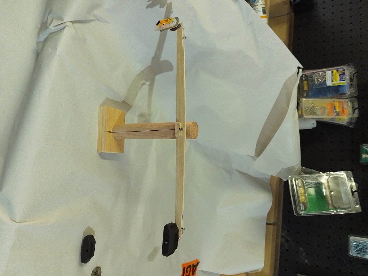

danny_galaga Posted October 2, 2023 Author Posted October 2, 2023 Well, Qld is celebrating some random old persons birthday today, so I am going to start pulling em apart. It's midday, why haven't I started yet? This is why
onetrack Posted October 2, 2023 Posted October 2, 2023 I dunno - that looks like some dodgy, el-cheapo, Chinese-made, set of scales! I'd be pretty wary of using them!
danny_galaga Posted October 2, 2023 Author Posted October 2, 2023 13 minutes ago, onetrack said: I dunno - that looks like some dodgy, el-cheapo, Chinese-made, set of scales! I'd be pretty wary of using them! 😞 I just finished making them. Accurate to 0.05 grams. Thought I should have the scales ready before I take the floats out. I believe they should still be wet, and then dry them for a minute before weighing. 1
danny_galaga Posted October 2, 2023 Author Posted October 2, 2023 33 minutes ago, facthunter said: The good ones pivot on AGATE wedges. Nev That's great. I didn't have any agate wedges on me, but the K & S tubing I used swivels with less than 0.05 grams on one side. Feel free to send me some agate wedges for my mark 2 version. 2 1 1

danny_galaga Posted October 2, 2023 Author Posted October 2, 2023 Right hand carby floats - 3.2 grams and 3.15 grams 1
danny_galaga Posted October 2, 2023 Author Posted October 2, 2023 Things you learn. Mine have the R written on them. Good to know https://www.rotax-owner.com/en/912-914-technical-questions/8174-float-weight 1 1

danny_galaga Posted October 2, 2023 Author Posted October 2, 2023 Or perhaps use what I already made. The carbs look great, which is a concern in a way because I was hoping for something obvious. It may be that I have removed a blockage or something without even noticing when I cleaned them up. Since it was pretty simple to remove and inspect, and I know the floats are ok I will get the basic O ring and gasket set and put em back together 2 1
