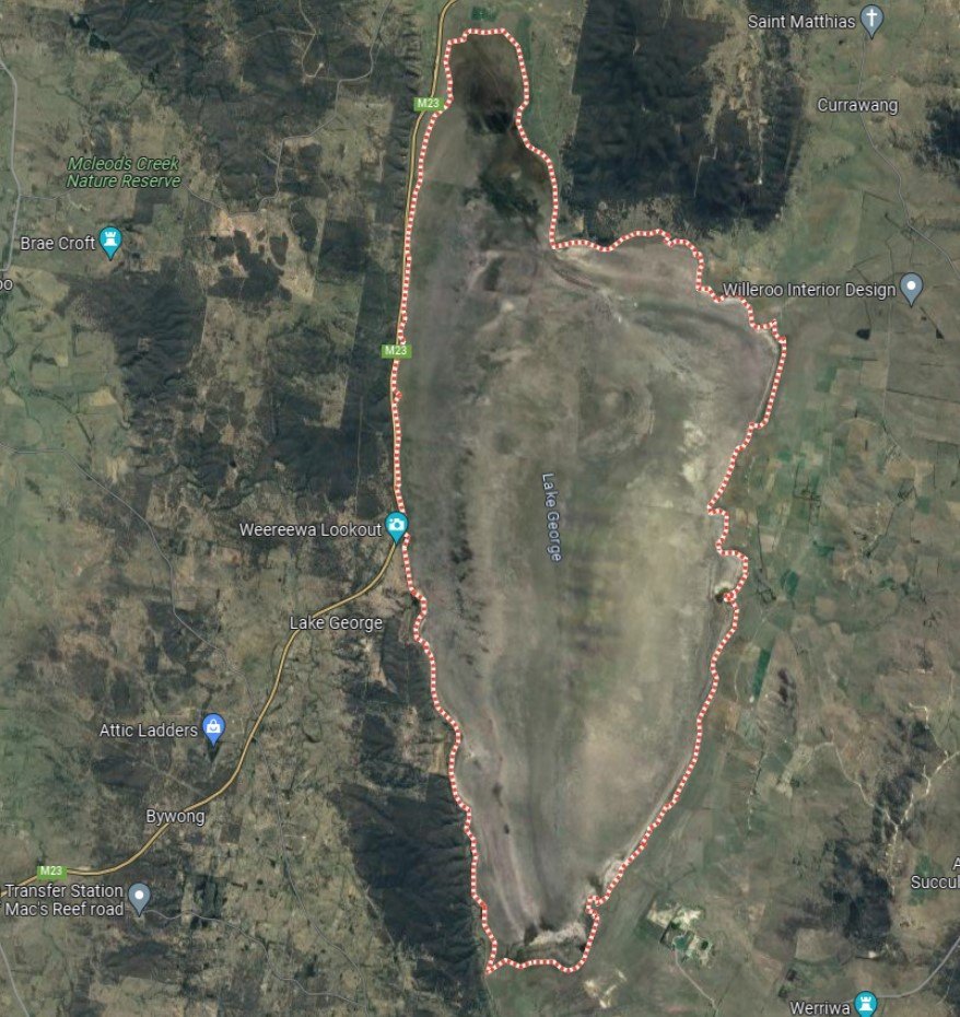

old man emu Posted October 7, 2023 Posted October 7, 2023 Here's the Canberra weather for 6/10/23 That's a weird swirling of wind direction around the time of the flight. My first thought was something like a rotor, or mountain wave. The location of the impact, just west of Weereewa Lookout makes that a thought. A high ridge is located right along that western section of the lake, then the ground is a flat plain across the lake to the East. Obviously if someone has a plot of the track it would be useful to see.

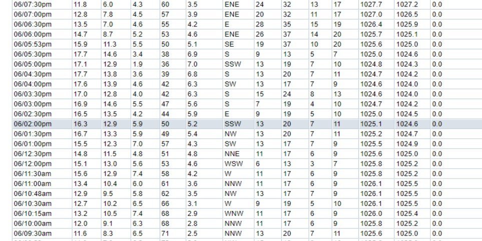

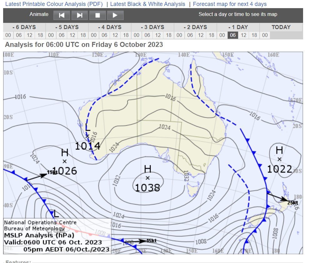

old man emu Posted October 7, 2023 Posted October 7, 2023 51 minutes ago, turboplanner said: My view is that there were two different air masses: lower down light winds from the WNW, unstable and moist; higher up (over 6000’) winds from the SSW Something was sure moving through Canberra from midday to 1500. Look at the wind directions: SSW to E then S over one hour. The wind speeds don't seem horrendous. The MSL isobaric chart doesn't help much.
facthunter Posted October 7, 2023 Posted October 7, 2023 You know something is happening because of the Kink in the isobars and it's under the influence of a high pressure system, so you have descending cold air mass. Nev 1 1
facthunter Posted October 7, 2023 Posted October 7, 2023 .... Which is usually more stable and the distance between them would not indicate High velocity winds either. Orographic effects could be involved. There's high country south of Canberra.. IF an Airline is cancelling flights due turbulence ATC would certainly be aware of it. Traffic north of Canberra has to be slotted in with other from the West and South bound for Sydney and Newcastle. Nev 1
