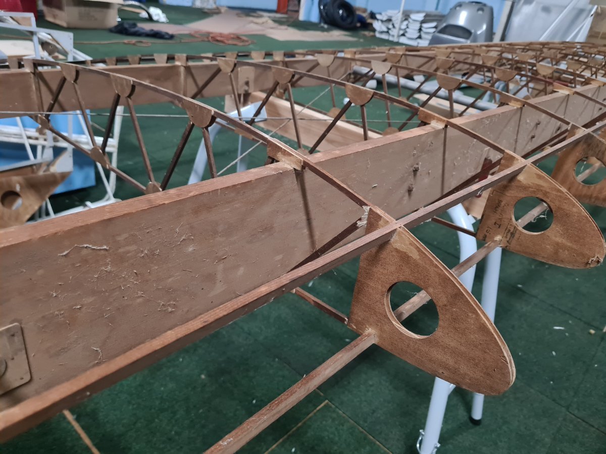

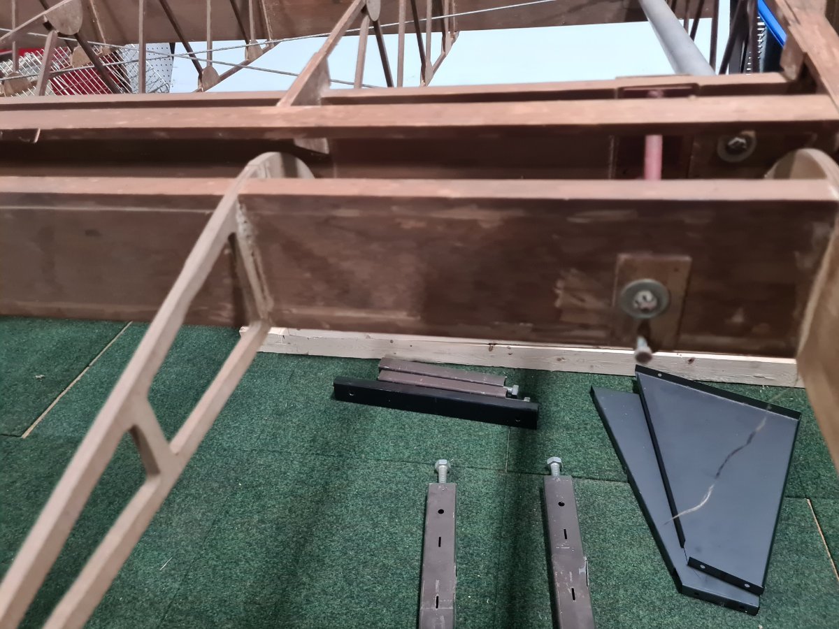

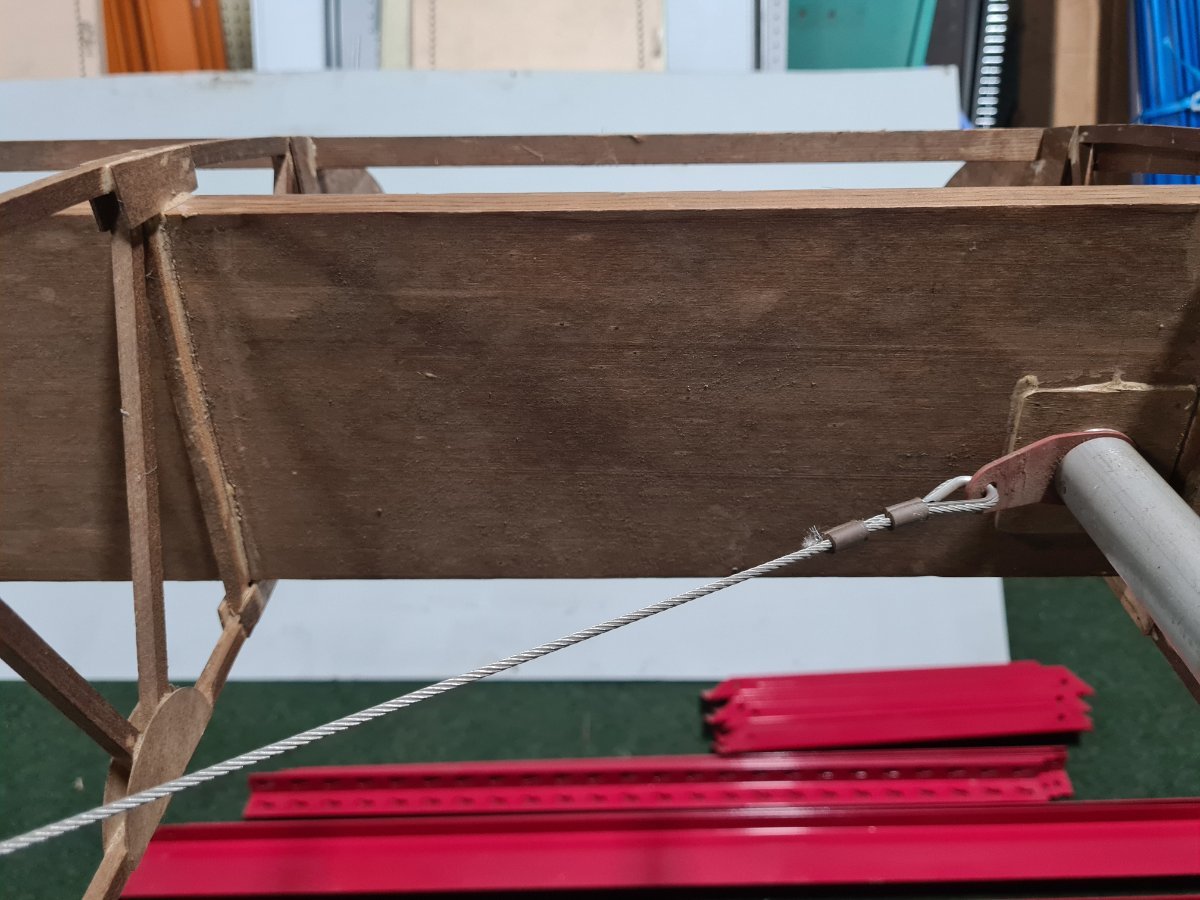

Peasant_Pilot Posted October 20, 2023 Posted October 20, 2023 Good evening all, Just looking to get some insight on inspecting wood wings, they are uncovered and mostly constructed, they are either Spruce or Hoop pine but id say they are hoop pine just based off the information i have. besides the obvious things like cracking and splits etc, are there any techniques, checks i can do on the spars? moisture check etc Cheers in advance Cheers Rob
djpacro Posted October 20, 2023 Posted October 20, 2023 https://www.faa.gov/documentlibrary/media/advisory_circular/ac_43.13-1b_w-chg1.pdf 1 1
440032 Posted October 22, 2023 Posted October 22, 2023 Spruce has nice visible grain, hoop pine much less so. Post some photos perhaps.
Peasant_Pilot Posted October 22, 2023 Author Posted October 22, 2023 They have been in a shed for years, some bird crap in a couple of spots and a lot of dust 1
