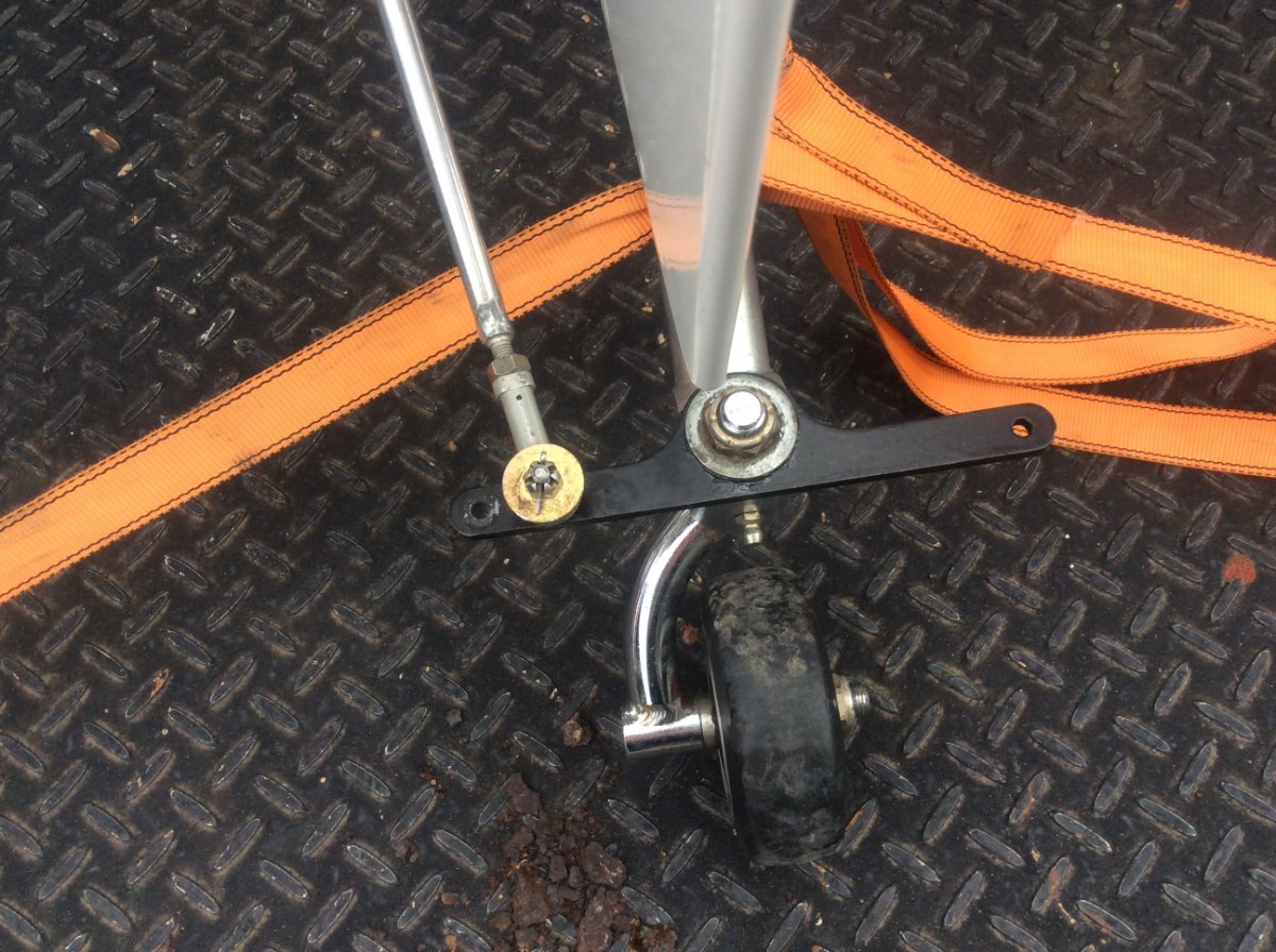

skippydiesel Posted October 26, 2023 Posted October 26, 2023 My Sonex has 50 Hobb hrs - from the start I have had great difficulty in getting the tailwheel to break away/swivel in a hard left turn. The right turn performs flawlessly. The 4" ingle fork, tailwheel assembly is by Aviation Products Inc (API) https://apitailwheels.com/ (yes have written and waiting for response). Similar slightly larger unit by API, featured in Kitplanes https://www.kitplanes.com/tech-tip-tailwheel-tune-up/ Observations: The aircraft tracks straight on the ground ie tail wheel is correctly aligned with airframe. Mechanism - a cam operated spring loaded pin designed to unlock at about 33 degrees from centre/straight. Appears as new, in good condition. My steering, from rudder horn to control arm, is via a single rod (some adjustment available). Right rudder horn is on stop, just before swivel action (break away) available . Left rudder horn is on stop and mechanism will not swivel. Have relocated steering arm in towards pivot point by about 25mm - swivel works well both directions BUT occurs just before rudders horns engage stops. My concern is that it is now possible to ground loop inadvertently (ie before rudder hits stops, which is the warning to pilot that swivel steering may be activated) when almost full rudder defection is achieved. Is this a safety issue? Bear in mind that some of these aircraft operate an uncontrolled/spring cantering tail wheel ie all taxy steering is purely on differential brakes.

skippydiesel Posted October 30, 2023 Author Posted October 30, 2023 There being little comment/advice on the matter - I feel that I will have to live with the latest set up, that is the steering rod connecting to an inner hole (closer to centre pivot point), changing the "throw" of the left turn so that it can break away/swivel. The L & R swivel action now occurs before rudder horn contacts the stops and is significantly easier to initiate. My ground opps. will have to be carried out with a higher degree of caution and my line up will include a check for posative straight steering before commencing ground role.

skippydiesel Posted October 31, 2023 Author Posted October 31, 2023 This is how my tail wheel steering is configured now, giving about equal breakaway/swivel left & right. You can see the "old" steer rod position just to the left. 1
