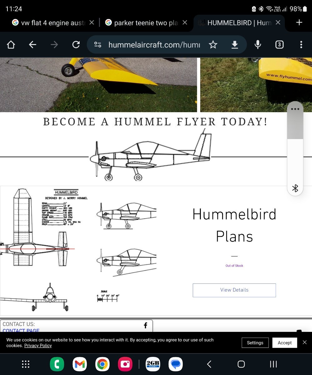

Geoff_H Posted November 12, 2023 Author Posted November 12, 2023 I went and looked at the HB. Plans are out of stock! Why would this be? Surely they only take a day to make. Are they stopping offering these plans in preference to another aircraft in their line-up.

Geoff_H Posted November 13, 2023 Author Posted November 13, 2023 This is the craft that appeals to me. Plans are not available

Geoff_H Posted November 13, 2023 Author Posted November 13, 2023 Trouble Nev is my passport is out of date so I can't enter Victoria (lol). Spacey lives only a handful of kilometres away from me. I am hoping that he can put some light on the issue. I think that the Hummel classic, which seems to be more relevant to me is being discontinued. Very little seems available as the company appears to be heading in the direction for kits.
