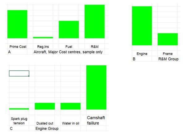

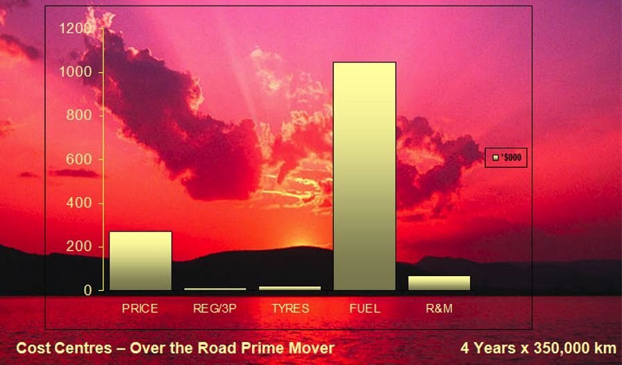

turboplanner Posted December 5, 2023 Posted December 5, 2023 For those who've never done Unit costing or had trouble was just a depiction of cost centres which you could apply to soup makers or TV sets, Chart A is its equivalent, marked "Aircraft". I just picked 4 cost centres to make it simple; the columns are not loaded so not to scale. Chart A reads from all the other sub-charts. In this case R&M looks high. Chart B This is the R&M sub group, I've limited it to two subjects, but nothing to stop you having 20. In this case the problem seems to be in the Engine category. Chart C This is the engine sub group. I've just picked 4, but you could have many such as electrical system, fuel system, oil supply system accessories etc. In this case the first three look to be isolated but camshafts are out of control. Chart D etc I haven't drawn this but somewhere along the way the costs are isolated by make, model and the location they are operating. Conclusion We know that make X has an endemic problem with camshafts spread across all airfields surveyed and we have to make a decision to either work with the Manufacturer (warranty, out of pocket costs) or buy something else. In most cases you see the pattern forming very early in the interview process, and the benefit of doing this is that you know the exact truth rather than relying on corporate propaganda or social media.
