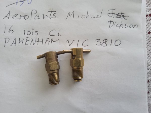

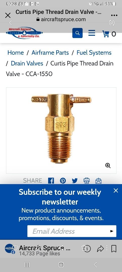

spacesailor Posted December 8, 2023 Posted December 8, 2023 There you go : After buying Two " Curtis N,P.Taper valves!. only to receive " N.P.Straight valves. The first returned but no postage . Gets expensive . The second one doesn't return my messages . So I will try " Skyshop " . Why don't they use English : Taper or Straight .: instead of , Curtis N,P,T, 1550 . " Such is life " spacesailor 3
facthunter Posted December 9, 2023 Posted December 9, 2023 IF the part is shown the straight one has to have enough shoulder to have a sealing washer to contact it. The taper thread is visibly obvious also. Nev
spacesailor Posted December 10, 2023 Posted December 10, 2023 NOT that visible. Was going to return it but they never answered my email . So have to wear it. spacesailor
facthunter Posted December 10, 2023 Posted December 10, 2023 NO shoulder. The thread doesn't look to have the Taper it should. Nev
Thruster88 Posted December 10, 2023 Posted December 10, 2023 3 hours ago, spacesailor said: NOT that visible. Was going to return it but they never answered my email . So have to wear it. spacesailor Just swap the Oring to your old one.
spacesailor Posted December 10, 2023 Posted December 10, 2023 But how do you get the o ring off . So ! . Not fit for purpose . Therefore I should have a refund or replacement. Then , that postage cost , wipes out most of the refund . spacesailorl
kgwilson Posted December 10, 2023 Posted December 10, 2023 Simple. Remove the valve. Push and twist the spring loaded shut off valve so the bar sits in the open position seat, remove O ring & fit a new one, flick the bar back & it closes.
spacesailor Posted December 10, 2023 Posted December 10, 2023 But ! , That 'simple ' remove the Oring, is hard , to get a grip on it . Can a ' pin ( needle ) be used to get under the rubber ring . Without damage . Then were, to buy a new " Oring " .as it has to be petrol proof. spacesailor
facthunter Posted December 10, 2023 Posted December 10, 2023 I think they ALL are these days. Use a plastic knitting needle. Nev
spacesailor Posted December 10, 2023 Posted December 10, 2023 Too big for that ' size ' Oring . spacesailor
facthunter Posted December 10, 2023 Posted December 10, 2023 Wooden toothpick then. Have clean hands and "pinch" a rise in the "O" ring and raise it with the thick end of the toothpick and ease it off. Auto spares shops should have various sized O rings Nev 1
skippydiesel Posted December 10, 2023 Posted December 10, 2023 (edited) You can also purchase a set of handy awl type O ring removing tools : These are $17 on eBay - very handy Edited December 10, 2023 by skippydiesel 1
spacesailor Posted December 10, 2023 Posted December 10, 2023 I used a ' crochet ' hook !, & found the Oring was split . Now I know why it keeps a steady drip . spacesailor
kgwilson Posted December 10, 2023 Posted December 10, 2023 Good grief. You don't need any tools. Cut the old one off & roll the new one on. 2 1 1
spacesailor Posted December 11, 2023 Posted December 11, 2023 Sounds like ' you're a surgeon ' This Oring is SO tiny 6 mm OD . Maybe 3 mm ID. & 1 & a bit thick . spacesailor 1
