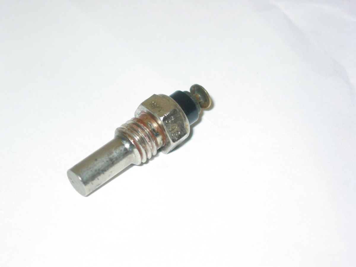

Rotax temperature sensors - coolant & oil are the same;
image.thumb.png.1085958e17203661cbe70c9e60ef2302.pngFor best connectivity, a sprung female spade connector is best egimage.png.b26ec0ec72f0640b7d585a48bd4678af.png
Oil pressure senders are something else - may depend on your head system.
