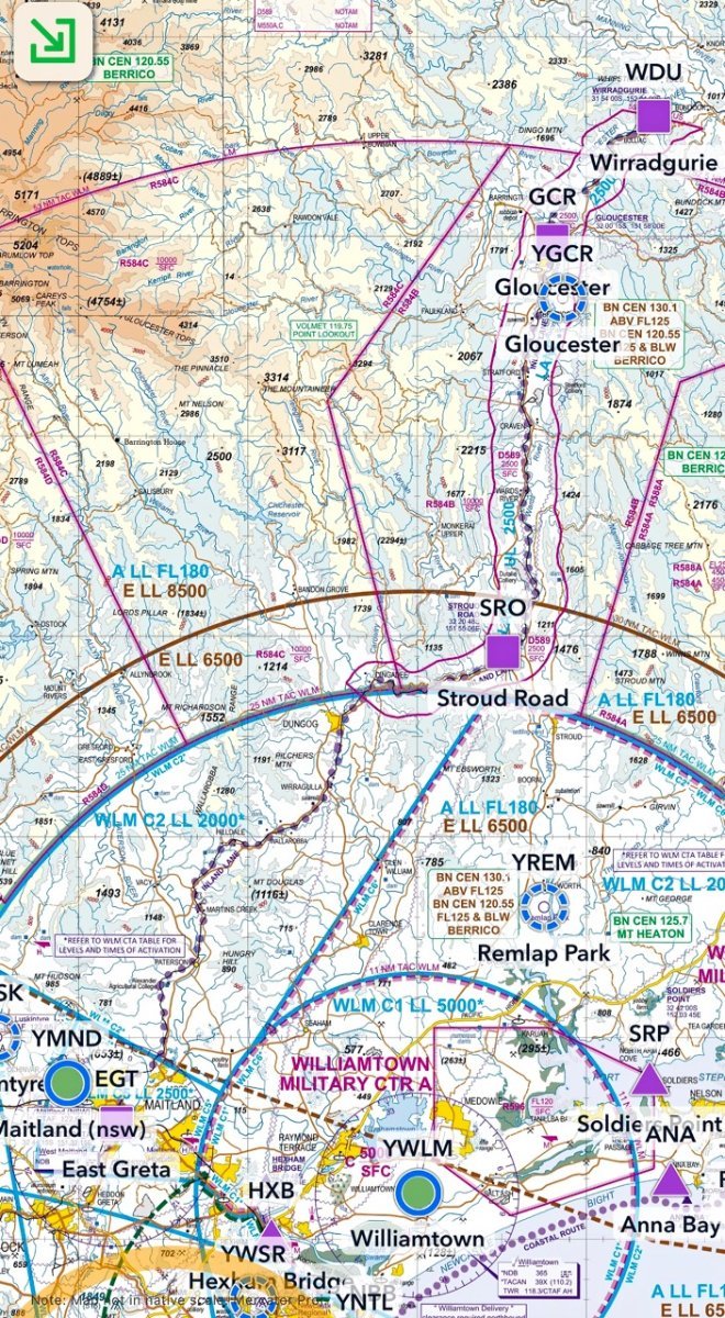

Garfly Posted January 12, 2024 Posted January 12, 2024 Things have changed with the Williamtown Inland Lane. As I understand it, the south half of the Lane from Dungog to East Greta/YMND no longer penetrates a Restricted Area but lies underneath a new Class C space WLM C2 LL2000 The northern half still does (D589 'tunnels' through R584B - UL2500) Effectively the main change for VFR flights on the south half seems to be an extra 400' headroom. (up from 1600') Also, there's a new 2,500 LL above YMND (Maitland). CLICK FOR FULL REZ: Williamtown (YWLM) FAC.pdf a23-h45 (1).pdf 1
skippydiesel Posted January 13, 2024 Posted January 13, 2024 Thanks for that Garfly - I have only done this route once (south to north) - it was horrible! What should have been a pleasant scenic flight, was marred by strong mechanical turbulence, close proximity of high terrain and unsafe altitude limitations. Returned by a diffrent route. 1
RFguy Posted January 13, 2024 Posted January 13, 2024 yeah as I read it , just get a class C transit clearance from the mil guys and life is much easier, now. IE you will be accomodated if at all reasonable and possible, compared to, in the past, the opposite. 1
Garfly Posted January 13, 2024 Author Posted January 13, 2024 As long as you pass under the LL2000 shelf of the WLM C2 (southern half of the Lane) you shouldn't need any clearances. So it's pretty much as it was for VFR transit, except for another 400' of headroom in the lower part of the route. And, if you are able (a/c rego and licence) to request clearances, you might be better off asking for the coastal route. 1
sfGnome Posted January 13, 2024 Posted January 13, 2024 I’ve flown this inland route a number of times. On a nice day, it’s a lovely sightseer. On a rough day, it’s awful. No escape from the turbulence. The extra height in the first section will be good. I’ve only done the coastal route once (with a suitably licensed pilot). It was interesting seeing the sharks swimming near the surfers… 🫣 3
