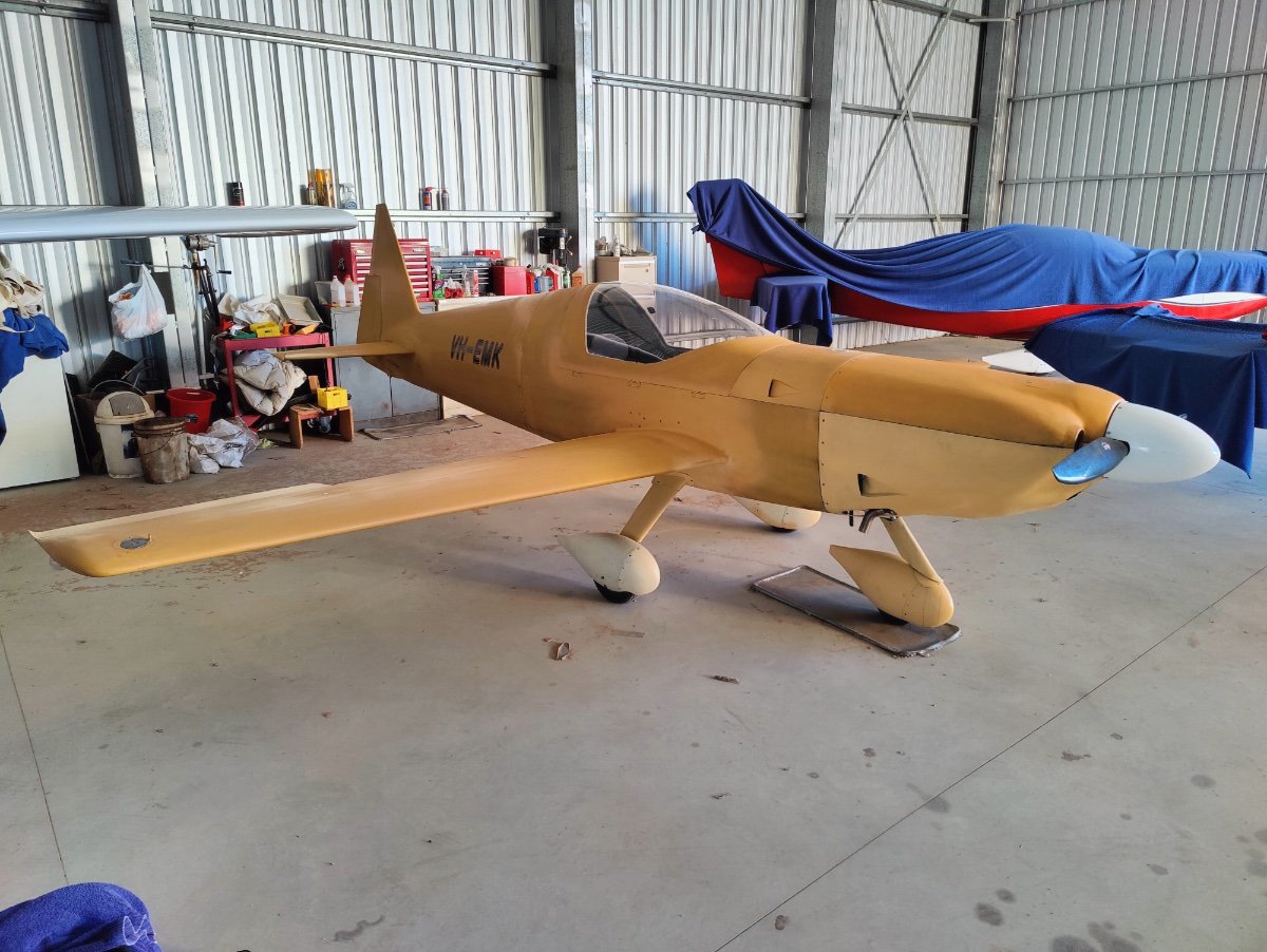

Rapture Posted January 12, 2024 Posted January 12, 2024 Hi everyone. I know we have some very passionate aviators on this site and I’d like to gauge the potential interest in a high performance single seat ready to fly or kit LSA. The beauty of the Australian LSA regulations is that we have removed the top speed limitation, while maintaining the balance of the international LSA frameworks. Our team within Rapture Aircraft have a couple of airframes flying. We have one in Adelaide powered by a Jabiru 3300. This aircraft is currently topping out at close to 200 knots. We had one flying in the US with a Rotax 912ULS that topped out at about 186 knots, but the prop was not optimised. Photos of both aircraft are attached. This aircraft currently has a wing area of 40 sq.ft. and stalls at around 55 knots with landing flaps. As part of a project with the aircraft that we are working on, we are scaling the wing to provide an area of 66 sq.ft. One of the repercussions of doing this is that the new wing could potentially offer a stall speed that meets LSA criteria. This configuration would still offer bugger all drag at cruise speeds. We know that a Rotax 912 fits under the cowl ok, but we are thinking that a 155hp Edge Performance 912sTi would be a nice powerplant that with its turbocharging would offer excellent performance at both sea level and at altitude. A 200 knots cruise should certainly be attainable with this powerplant. The current airframes are Vne limited to 220 knots (designed for and flown to higher speeds by the original designer, but a conservative number was subsequently placed on the Vne). However, the design overhaul that is being carried out will offer a higher Vne. The ready to fly aircraft wouldn’t come cheap, particularly given the cost of the engine, but the question I have for forumites is whether in your opinion there would be legitimate interest for folks to buy a 200 knots ready to fly single seat LSA? Of course, the alternative to the high performance high cost variant is to offer a Rotax 912/Jabiru 3300 powered low cost variant that would only offer a 160-180 knot cruise. We will still plan to offer the original wing for the super high performance kit market, but with the big wing making the aircraft LSA eligible, we want to explore that market. I would appreciate your opinions or comments about the concept of a high speed single seat LSA. Dave 2

Rapture Posted January 13, 2024 Author Posted January 13, 2024 Thanks RGMWA and FH, we are already targeting experimental as our primary market, but as well as LSA, MOSAIC is likely to be introduced to the US in the not too distant future that will facilitate factory build assist or full factory build. The RTF variant could also fit into that framework in the US, opening up the market there to more completed aircraft than the experimental category now offers. An LSA variant for the Australian market would be complementary to a US MOSAIC offering. Flutter is not an issue for this aircraft. It has had a full flutter analysis completed and the flying ones are regularly flown to 220 knots and in some cases, faster for test purposes. 2

Rapture Posted January 13, 2024 Author Posted January 13, 2024 11 minutes ago, kgwilson said: What's the empty weight with a 912? 597 lbs empty weight. 24usg fuel capacity so maximum 145 lbs fuel means 742 lbs with full fuel and no pilot. This is a heavy build airframe with 3 coats of paint and heavy steam instruments. With the new carbon airframe and EFIS, we anticipate a lot lighter empty weight for the same engine. We have set a MTOW for the current flying 912 powered airframe at 1,000 lbs. so a 258 lbs pilot and bags allowance. With the new build, we will allow a MTOW of either 1,000 lbs or 1,100 lbs (TBD) with the 40 wing and 1,200 for the 66 wing.
Rapture Posted January 13, 2024 Author Posted January 13, 2024 As another data point, our Jabiru3300 powered Bug has an empty weight of 601 lbs, only 4 lbs more than the Rotax 912 Bug. Clearly, the Jabiru Bug is built lighter than the Rotax one. The new build carbon one will be lighter still by an estimated 30 lbs in basic structure. We will save more weight in the lighter panel. FYI, the nosegear retracts on the Rotax Bug to achieve its 186 ktas top speed while the Jab Bug has a fixed nosegear (more drag) and the Jab Bug also has a rough primer finish. With a smooth paint job, it will pick up another probably 15 lbs of empty weight but will have less skin friction. We anticipate that the Jab Bug will hit 200 ktas top speed with the paint job. The Jab Bug currently cruises at an economical cruise fuel flow of 20 litres per hour at a leisurely 180ktas. Compare that to the J230 that I fly occasionally where the 20 litre per hour fuel burn yields about 110-115 ktas. That indicates that the aerodynamic efficiency of the Bug is pretty good. Of course, it is a single seater but even still, its performance is impressive.

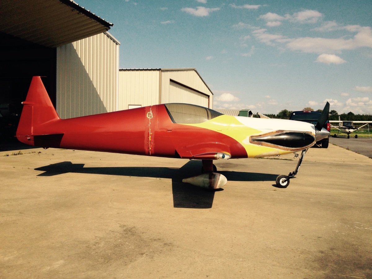

Rapture Posted January 13, 2024 Author Posted January 13, 2024 Here’s a bit of a teaser. We currently have one of our flyable nosegear retractable Bugs being prepared in the US to be shipped later this month back to Adelaide. It is going to be used to assess performance with a 200+hp engine fitted. With a Vne of 220ktas on this airframe, we won’t be testing top speed but we will certainly be able to extrapolate performance out to estimate a top speed. We will also be able to determine takeoff and climb performance with the powerplant. Both are likely to be fairly impressive given that the Jab Bug at 120 kias gives a 1700fpm climb at quite reduced rpm due to the current fixed pitch prop limitations. We will have a true 200+hp available in all phases of flight for our test unit. Once we have the new build Bug available, we will transplant the powerplant into the new build where we will be able to test top speed properly. Fun times ahead. I wonder what CASA/RAAus would think of a 250 knot RAAus registered aircraft…. Anyway, more on this project in due course. The airframe is scheduled for delivery in late March then we have to fit the engine. It’ll be quiet until then on that project.

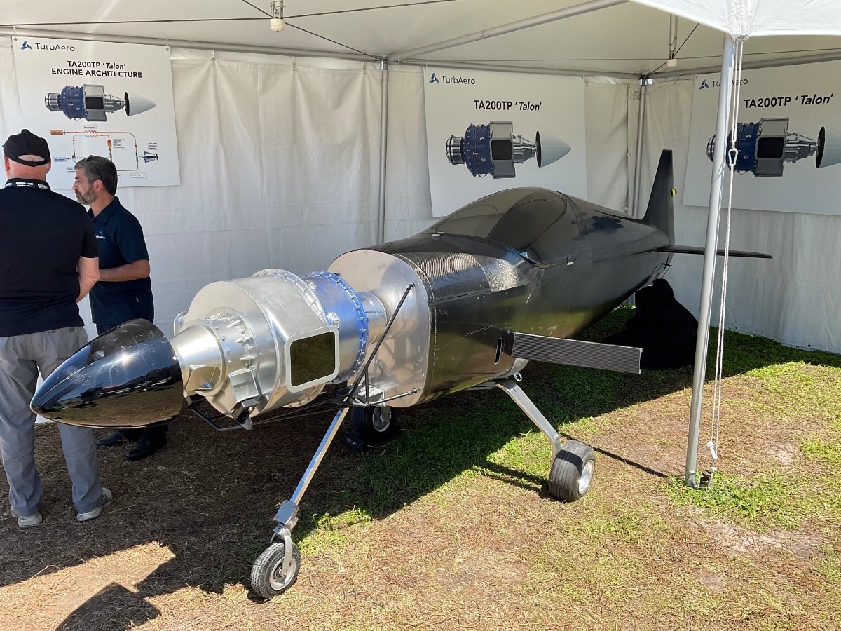

Rapture Posted January 14, 2024 Author Posted January 14, 2024 (edited) 4 hours ago, pmccarthy said: These look like the same two aircraft that Flyvulcan was telling us about in 2010. That is 14 years ago! It is! To say that this has been a slow burn project is an understatement! I have spent the last 7 years developing a powerplant solution for the airframe (TurbAero turboprop) which I am still extremely busy with. The Bug development has taken a back seat to my full time job with TurbAero. I am now, with the help of my partner in the Bug venture pushing ahead with the Bug program through our Rapture Aircraft entity. The Bug is primarily an experimental aircraft. The 40 wing precludes it from the LSA category. The 66 wing is being considered for a very specific and one-off application for the Bug. However, one of the upsides of the big wing is that it potentially lowers the stall speed into LSA limits when flapped. So, that opens up the potential for an LSA variant, to complement the experimental variant. 2 hours ago, RFguy said: yeah I dont see why this needs / should be in LSA category- surely VH-EXP? A Va of 145 kts implies for a 3.8g aircraft, a clean stall of at least 74 knots.... or 59 kts for 6g aero category. Sounds like quite a bit of runway required and skilled pilots. The 66 wing Bug does not need to be an LSA, nor should it be an LSA, but it could be an LSA. If it meets the LSA criteria and there is an adequate market to justify offering it as a RTF option, I would have anticipated that there would be support to make it available as an LSA option. The Va of 145 is for the 40 wing Bug, I.e. the experimental variant, not the potential 66 wing LSA variant. The redesign of the Bug is enhancing the ultimate g for the airframe. This will reflect in the new Va that will need to be established for an LSA variant. The takeoff roll of the Jab3300 Bug is only about 400m so not a lot different to a Jabiru LSA. Landing is closer to 5-600m though. Concerns about speed-related safety issues have been raised as a reason for not offering it as an LSA. Learning to operate an aircraft in a higher speed envelope is alway challenging, where speed management is important. However, in the low speed regime, this aircraft would meet the LSA stall speed criteria and as such, would be the same as any LSA out there who just meet the LSA stall speed requirements. If the stall is benign with good stall warning, then the risk in this flight regime is reduced. Perhaps an angle of attack warning system could be feature of a RTF Bug to provide further comfort and awareness in this area. Attached is a photo of the new all-carbon Bug fuselage that we are building up into the new build Bug. Disregard the FWF stuff. That’s not the real nosegear, simply something added to get it onto some gear to display at Oshkosh. The new engine mount will incorporate the retractable nosegear mechanism. A new main gear will also be installed. The fuselage is sitting on a cradle that you cannot see in this photo. Edited January 14, 2024 by Rapture 1 2
