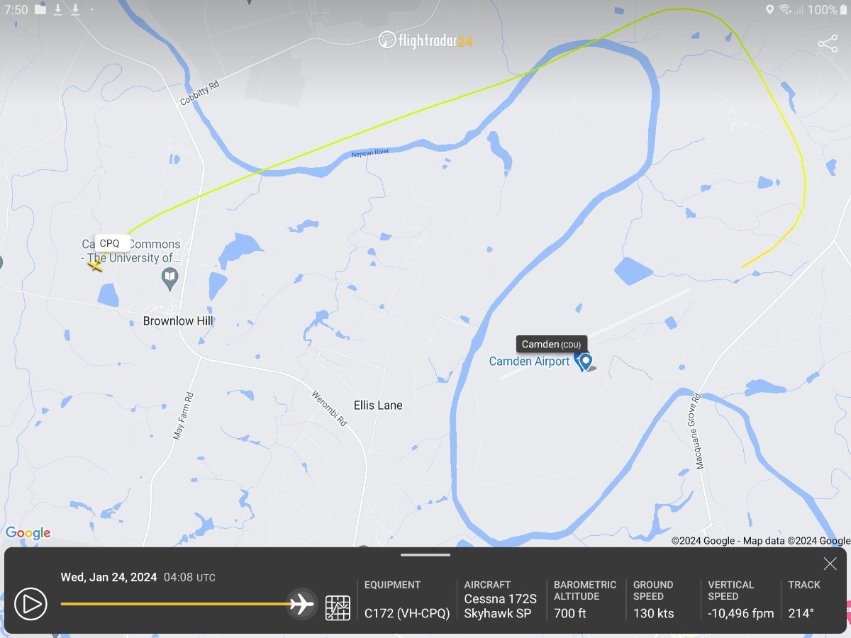

Thruster88 Posted January 27, 2024 Posted January 27, 2024 At the commencement of the base turn the adsb data is showing 79 knots ground speed and 1500 baro altitude. Shortly after plus 50 knots and 800 feet lost.

skippydiesel Posted January 27, 2024 Posted January 27, 2024 Seems to me that that is an extraordinarily wide/long circuit - the pilot may have been having problems quite early on in the flight
RFguy Posted January 27, 2024 Posted January 27, 2024 (edited) Possible skippy that he had a big NE tail wind? hence ending up with a very deep downwind if he was not lookin gback at the strip ? (and resulting low airspeed even though 79 kts ground speed, but that would be a 30 kts tailwind to have a '172 run out of lift in cruise, well more than that because the aircraft would have been low in weight so perhaps 35kts tail , not sure I buy that, instructor wouldnt send him up in the wind) . so, no I am begginning not to buy the stall spin cause. unless he got disorientated, distracted started looking around and didnt take care of the ASI.... Edited January 27, 2024 by RFguy
KRviator Posted January 27, 2024 Posted January 27, 2024 Quote and the wind at the time 3:10pm local was ... dunno cant see back that far, suspect (S) easterly component. Instructor would not send him up if it was appreciably windy. The 1500 Camden AWIS a few minutes prior to the accident was out of the northwest at 9 gusting 13, so almost direct crosswind (Though the BoM records now show it as 8 knots, not a meaningful change really, but I note it on the grounds of accuracy). That being the case, GS would be almost identical to IAS on the downwind leg, if not slightly lower than indicated. Given there's no reduction of GS to anything resembling stall speed for a lightweight 172, I'm going to go out on a limb and say he didn't stall it or spin in. Compare the ADS-B data here with that from the Gundaroo prang, they're markedly different. It's a weird one, it almost looks like the beginning of a spiral dive, but I can't begin to fathom what would cause that at the base turn. Quote Seems to me that that is an extraordinarily wide/long circuit - the pilot may have been having problems quite early on in the flight ADS-B Exchange shows it to be within 150m or so of two previous circuits conducted by the same plane earlier that morning. Not sure if it was the same student or not, but I'm wondering if they turn Crosswind early due to a noise abatement restriction on overflying Wivenhoe Village, so rather than 500' upwind, turn, climb to 1,000, turn, they turn early causing a longer-than-normal crosswind leg, pushing the downwind leg further away from the runway than would normally be the case. Any Camden-based folks able to comment? One thing I did note was he was 200' high throughout his downwind leg. ERSA says 1,300' but he flew downwind at 1,500. 1

Roundsounds Posted January 28, 2024 Posted January 28, 2024 1 hour ago, KRviator said: The 1500 Camden AWIS a few minutes prior to the accident was out of the northwest at 9 gusting 13, so almost direct crosswind (Though the BoM records now show it as 8 knots, not a meaningful change really, but I note it on the grounds of accuracy). That being the case, GS would be almost identical to IAS on the downwind leg, if not slightly lower than indicated. Given there's no reduction of GS to anything resembling stall speed for a lightweight 172, I'm going to go out on a limb and say he didn't stall it or spin in. Compare the ADS-B data here with that from the Gundaroo prang, they're markedly different. It's a weird one, it almost looks like the beginning of a spiral dive, but I can't begin to fathom what would cause that at the base turn. ADS-B Exchange shows it to be within 150m or so of two previous circuits conducted by the same plane earlier that morning. Not sure if it was the same student or not, but I'm wondering if they turn Crosswind early due to a noise abatement restriction on overflying Wivenhoe Village, so rather than 500' upwind, turn, climb to 1,000, turn, they turn early causing a longer-than-normal crosswind leg, pushing the downwind leg further away from the runway than would normally be the case. Any Camden-based folks able to comment? One thing I did note was he was 200' high throughout his downwind leg. ERSA says 1,300' but he flew downwind at 1,500. You do realise the ADSB returns are based on pressure height? The QNH at 3pm was 1007, therefore you need to take approx 180’ off the ADSB pressure height return to get an altitude. 3 2
RFguy Posted January 28, 2024 Posted January 28, 2024 KG said : "One thing I did note was he was 200' high throughout his downwind leg. ERSA says 1,300' but he flew downwind at 1,500." BUT ! But that's just baro pressure, not adjusted for QNH. either he didnt have is altimeter QNH corrected or the QNH departed substantially from the calibrated). In a transponder, you dont tell it what the QNH is of course. It assumes ISA for altitude I dont know ith Flight Radar etc adjust for local QNH like ATC radar screens do.
