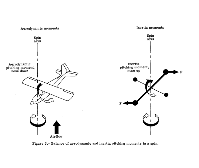

djpacro Posted January 25, 2024 Author Posted January 25, 2024 19 hours ago, djpacro said: To go a bit deeper into the subject for much of the underpinning knowledge required by CASA for a spin endorsement I suggest starting with NASA TN D-6575 SUMMARY OF SPIN TECHNOLOGY AS RELATED TO LIGHT I GENERAL-AVIATION AIRPLANES by James Bowman (I worked with Jim for a while). It is engineering stuff however fairly light reading. "The way in which the mass of an airplane is distributed between the wing and fuselage is the most important single factor in spinning because it determines the way in which the airplane, while spinning, responds to control movements, especially to elevators and ailerons. An airplane rotating in a spin can be considered to be a large gyroscope. Since there are mass and angular rotation about all three axes, inertia moments are produced about all three axes." Fig 3 shows the balance of pitching moments in a spin which basically determines the angle of attack in the fully developed spin. The nose down aerodynamic moments vs the nose up moments from inertia. Worth repeating NASA's statement: "The way in which the mass of an airplane is distributed between the wing and fuselage is the most important single factor in spinning ..." NASA is not referring to CG there but to the moments of inertia. "In order for the airplane to recover from the spin, the equilibrium must be broken, and this is normally accomplished by changing the aerodynamic moment by moving a control or combination of controls that can cause the greatest antispin moment. ....... The loading of the airplane dictates the control movements required for recovery. ..... Deflection of the rudder to oppose the spinning rotation directly is always recommended, but in many cases, it is not adequate to provide recovery. For the wing-heavy loadings, down elevator is the primary recovery control." "Three factors are of almost overriding importance with regard to spin and recovery characteristics: (a) The relative distribution of the mass of the airplane between the wing and fuselage, which is commonly expressed in terms of the inertia yawing-moment parameter, a nondimensional factor relating the rolling and pitching moments of inertia (b) The tail configuration, which must provide damping for the spinning rotation and the rudder power for recovery and which is commonly evaluated in terms of an empirically determined tail-damping power factor (c) The density of the airplane relative to the density of the air, which is commonly expressed in terms of the relative-density factor" We don't need to concern ourselves with effects of air density so just moments of inertia and tail design. Some aircraft types have weak nose down pitching moments so the nose up inertia moments drive them towards a much higher angle of attack in the spin. NASA has shown this for the Grumman AA-1 1 2
facthunter Posted January 25, 2024 Posted January 25, 2024 Stabilised spin pitch attitude. Not angle of attack. You can just look at some designs and Know they will be bad in the spinning state. Small rudder often shielded made worse by fin and rudder sweepback and short rear moment arm. When I started ALL pilots did spins in spinnable planes. Now most people just speculate what it is and how it's managed best. One thing is for sure. At a normal circuit height, No spin will be recoverable so best Don't get into one in those circumstances. Nev 2
