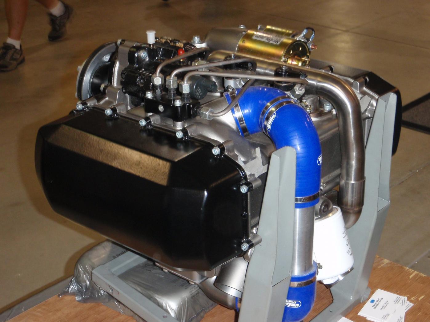

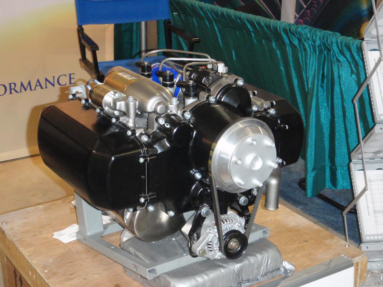

Keith Page Posted January 3, 2010 Posted January 3, 2010 photos Here are some photos of the gemini when it was at Oshkosk 2008.
