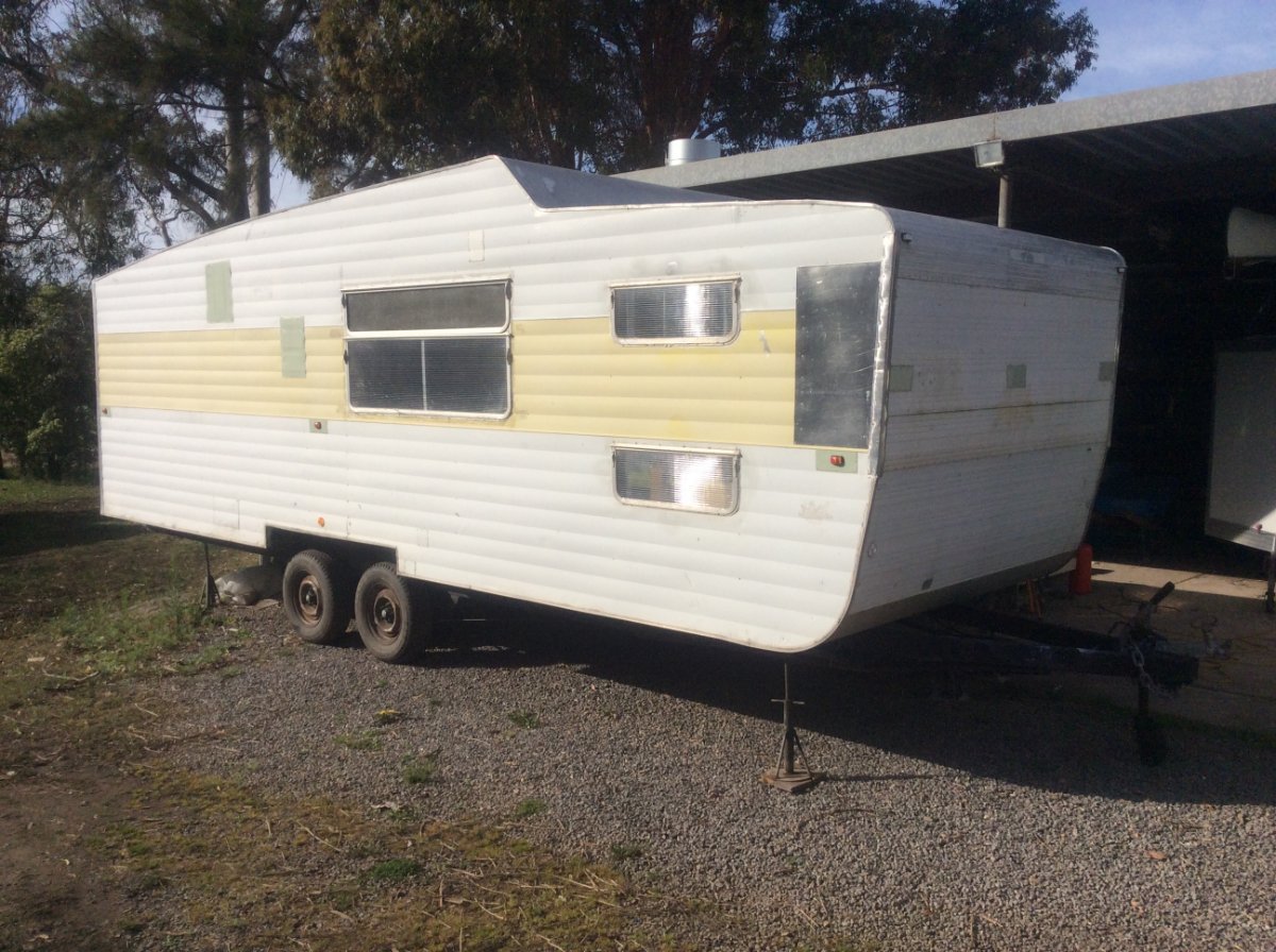

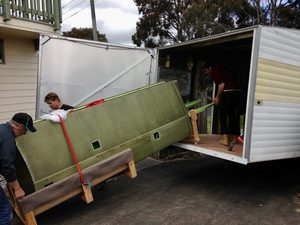

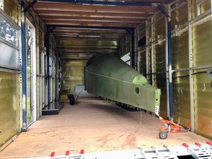

handy workshop or storage room when not transporting
The above "Aircraft Carrier" is a  1975 Viscount Supreme Caravan that I converted in a bit of a hurry to pick up the Sonex.
Towed it down to Leongatha, S Gippsland, Vic. Loaded the almost completed Sonex Legacy and returned to The Oaks NSW with no damage/difficulty. It was a 20 hr round trip. Vic roads are awful.
The Aircraft Carrier boasts internal tidowns, on each side, about every meter. It has also carried an RV 6.
Electric brakes on all 4 wheels and fully rebuilt suspension.
Its has NSW registration to near the end of the year.
Tows nice & straight - doesnt wonder.

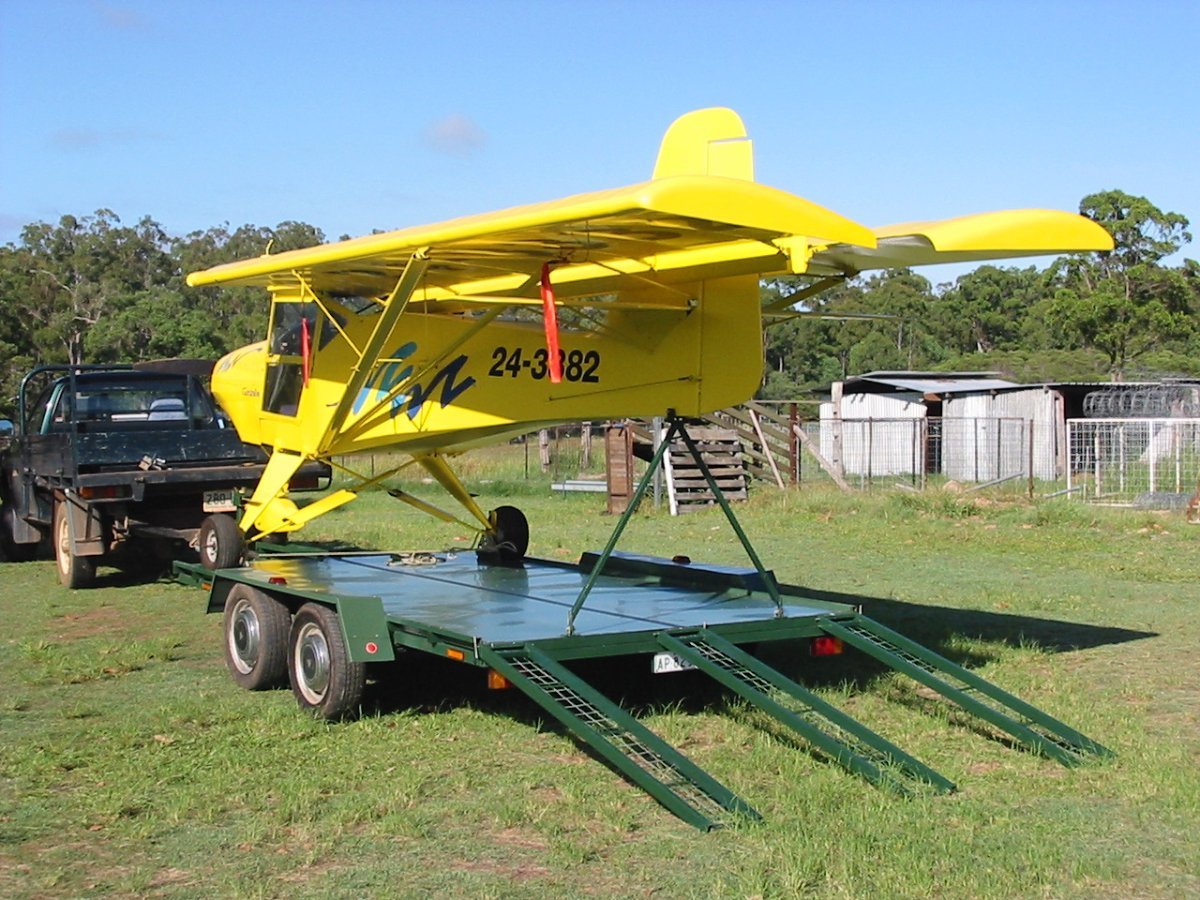

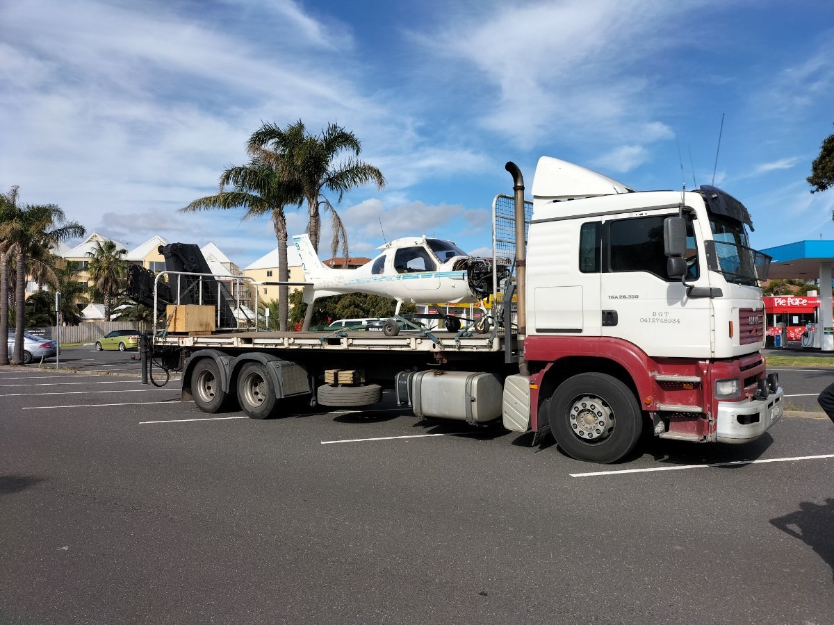

Not as flash but the flat bed is great.
I prefer my crane truck because the ride is gentle for anything on the back

skip , did you reinforce the caravan,  as I tried to do the same . But was advised the frame need'd the internal furniture for rigidity.

Yes - Your advisor was/is correct, however I have made good the integrity by installing additional ribs.
If you look at the photo with the fuselage inside, you will see blue steel square tubing. These "ribs"  plus the rear door frame, attached to the chassis, provide additional lateral rigidity. The original aluminium frame/skin provides longitudinal rigidity.
In addition to enhancing vans rigidity (probably better than what the original internal fittings provided) the ribs offer options for loading - components like wing empennage can be secured above the fuselage if required.
FYO -
  • Most of the windows were broken/missing -
  • Those that still had a functional frame, I replaced the glass with translucent polycarbonate corflute sheet.
  • I used the removed rear end body work, to fill in/delete the front windows entirely.
  • The van now only has one opening window and the two side doors for ventilation.
  • The three roof vents have been deleted and "patched" with sheet aluminium.
  • I replaced all 12V wiring & lights.
  • Aesthetically she looks a bit rough, being converted in a hurry, but is structurally sound - could do with a lick of paint.
The Aircraft Carrier is available for rent or purchase😎

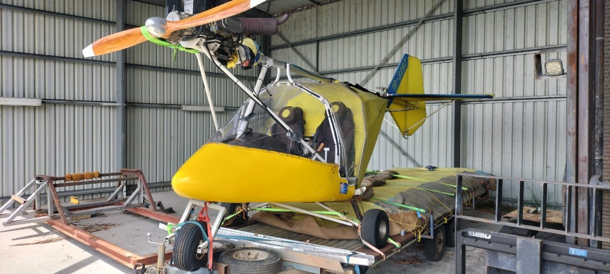

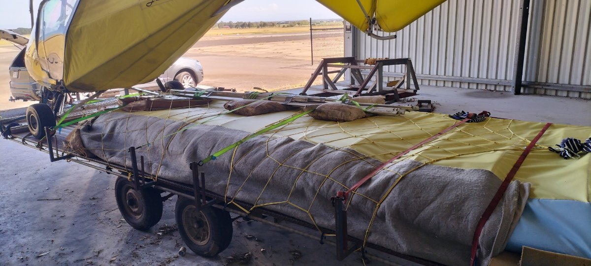

I went Gympie to Melbourne with  a four wheel trailer with a plank extending rearwards for the tailwheel and the wings removed and stacked together resting on foam on their leading edges  and strapped to a vertical square tubed steel frame down one side separated by and wrapped in  large rubber sheet foam spacers with all bits likely to rub protected. No way would I go any distance  with a set up like Bernie has shown. Opposing traffic will bring very high airloads with it. Especially Semis and maybe your plane will never fly again. I ran the tyres at reduced pressure too as there's not much weight involved. Being on it's own wheels,  tyres  and suspension, helped the fuselage to travel OK. It will need proper preparation even in a crate.  Nev

I agree, in general  BUT a "flat bed" trailer has the following potential disadvantages which must be managed;
  • As Nev pointed out the aircraft is subjected to buffeting (passing trucks/high winds) which may cause damage either directly or due to movement against restraints/tie downs.
  • Inclement weather - it is close to impossible to tarp an aircraft - best to wrap & use tape to restrain the covering (before tie down).
  • Gravel impact - as above
  • For items strapped flat on the tray (wings) deck movement/flexing could be transferred to the aircraft structure. (bending/abrasion). Need to secure load while allowing some movement.
  • Strapping damage - Styrofoam sheet/ bubble wrap/etc can be used to prevent  damaged from point loading/abrasion
  • Again as Nev mentioned - the trailer (or truck) is designed for much heavier loads, so suspension tends to transmit a lot of jarring  (known as shaking the crap out of everything)- low tyre pressure helps a lot to smooth the ride but be careful, lowering the pressure too much will cause tyres to overheat/blow out. I reduced my tyres from 45 down to 30 psi and checked wall temperature twice over the first  30 minutes and about every 2 hrs thereafter.
With a bit of planning and a lot of care the above can be mitigated even prevented.

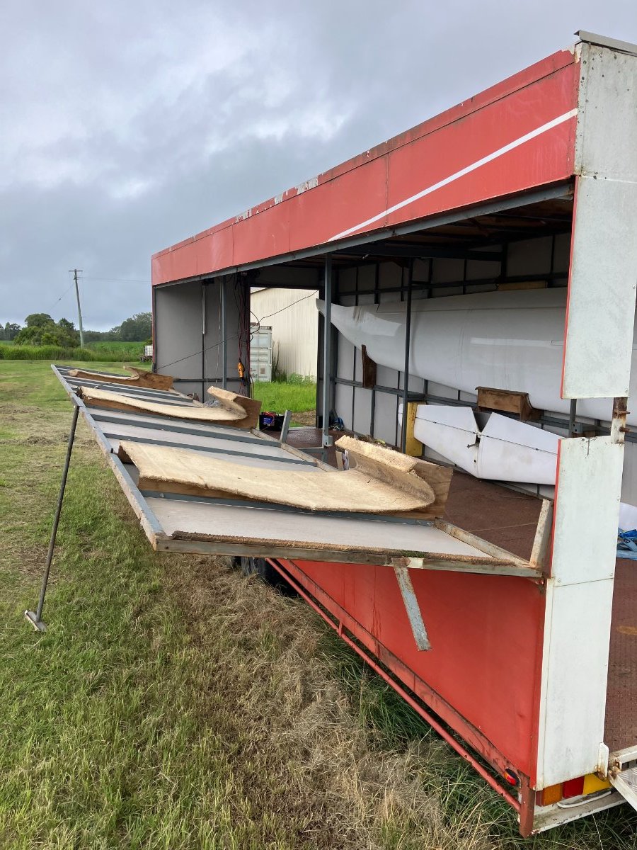

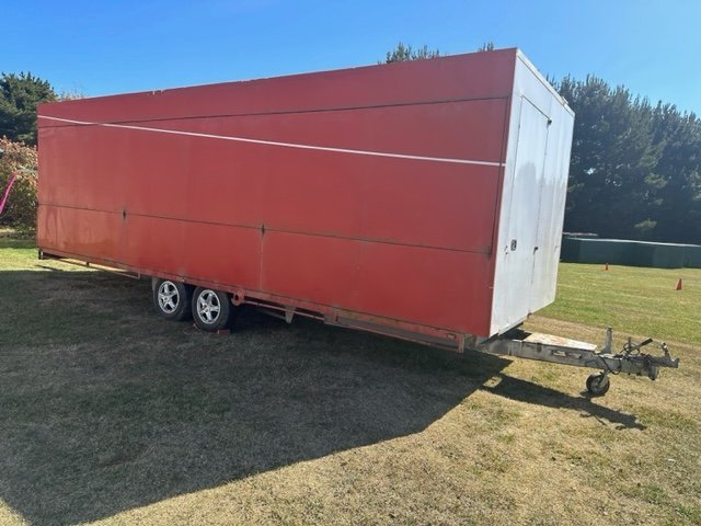

How about this purpose built plave carrier. Designed for a Pipistrel Aircraft but will fit anything, sides fold down for the wings to be fitted, electric winches, and long loading ramp will take just about any plane. Dual airbag suspension with special shocks.
I can get you the number if interested, there is a sign saying $7,500 on it.  Its just come a distance of about 2,000 kms so everything must be working.

I can only speak from a lot of experience and have never had problems. Have a look at how well packed the trailer was in my photo. Carpet . Foam and old pillows seperate and protect everything.
I don't know how the planes didn't fall to bits according to what I am being told here. A bit insulting really.
