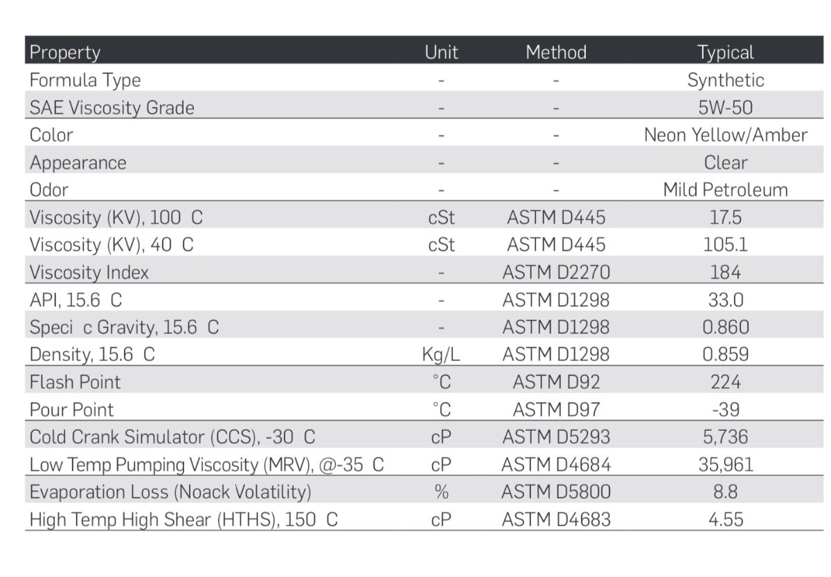

skippydiesel Posted March 7, 2024 Author Posted March 7, 2024 On 07/03/2024 at 7:52 PM, Reynard said: XPS aviation oil Expand WOW!!!!!! Its supposed to be a Rotax in house secret. I take it all back/apologise - if Rotax has in fact made this information available to the public. Dont know much about comparing oils with oils - usually just try to match the manufacture's' code numbers & letter with what's on offer and stick with the better known (reputable?) brands. So far (about 50 years) so good. If in doubt (often) consult with the brand technician. So anyone like to compare, the above Rotax XPS, with the reputable brands out there and see if they can come up with a match (likely to be a motorcycle oil)?
Reynard Posted March 7, 2024 Posted March 7, 2024 “Over two-years’ worth of development, forty tested variations of fluids, 20,000+ gallons of aviation fuel and 12+ fired engine tests led to the final formulation” From BRP.
facthunter Posted March 7, 2024 Posted March 7, 2024 AND it wouldn't have to be done IF it wasn't necessary. Would it? Nev
BurnieM Posted March 7, 2024 Posted March 7, 2024 It appears that this XPS oil is not a normal 5W-50 synthetic without friction modifiers. It appears to have a specialist/custom additive package.
skippydiesel Posted March 8, 2024 Author Posted March 8, 2024 On 07/03/2024 at 11:38 PM, BurnieM said: It appears that this XPS oil is not a normal 5W-50 synthetic without friction modifiers. It appears to have a specialist/custom additive package. Expand My understanding: the main concern, for Rotax, was the ability of the synthetic oil to handle AvGas ( scavenge lead). Straight synthetic oils being notoriously poor performers in this area. My guess: this concern is principally (not exclusively) for N American users of their (iS) engines - the use of AvGas, in Rotax engines, is still a hot topic in the N American Forums. The rest of the World seem to be reasonably happy with using ULP. The main benefit with AvGas is its availability at airfields - nothing to do with its suitability for use in Rotax engines.
onetrack Posted March 8, 2024 Posted March 8, 2024 (edited) The oil specifications in Reynards list is a basic ASTM oil specification list. It does not list specialist additives, which can vary from oil manufacturer to oil manufacturer. Lube oils are produced to basic ASTM specifications by the few oil refineries owned by the big oil companies, and then specialised additive packages are added by companies who engage in oil retailing. I used Golden Fleece oil in my fleet of earthmovers, construction equipment, trucks, road vehicles and plant items for over 20 years. GF produced very good quality oil - but it was made for GF by Caltex, because Golden Fleece never owned a refinery! But GF obviously selected the additive package, and I proved the superior performance of GF oils time and time again, after viewing and inspecting engines during strip downs. In the "old days", oils varied substantially because the oil companies sourced crude from their selected source, or sources, and that crude came with a huge variety of undesirable ingredients. Not a lot of people know that a percentage of sand is included in most crude! The refinery does its best to refine the crude to meet specifications, but often there are still a few undesirable chemicals in the final product. So the oil companies blend crudes from various sources, to reduce the impact of the undesirable residual chemicals. Then came catalytic cracking, a big improvement over thermal cracking. New refineries could produce pure base oils from lower grades of crude oil, free of chemical impurities. This is where the "synthetic" oils come from - the base oil from catalytic cracking is purer, more stable, less inclined to break down under heat and load, and less likely to acidify and oxidise. The additive packages are trade secrets, and you'll struggle to find out anything about what the oil lab chemists are actually putting in the oil by way of additives. And the companies constantly find new additives, with vastly improved properties over older additives - so they can change from year to year. If an engine manufacturing company advise you their branded oil is designed for their engine/s, you may pay a little more for it, but it removes any argument from engine failure claims, if you do use it. Edited March 8, 2024 by onetrack ...spelling 1 1 1
