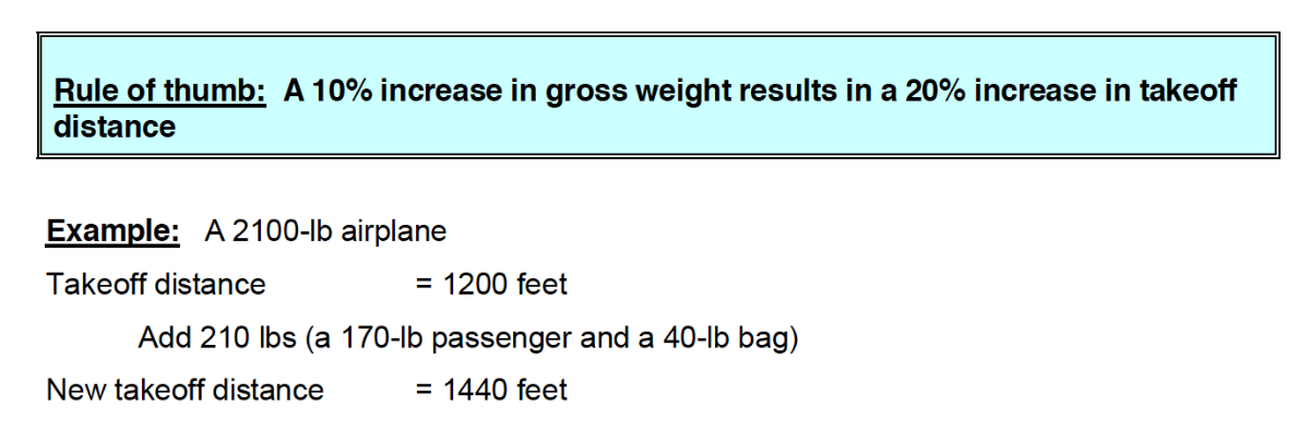

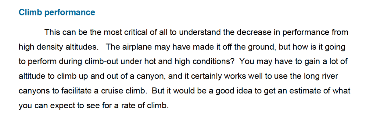

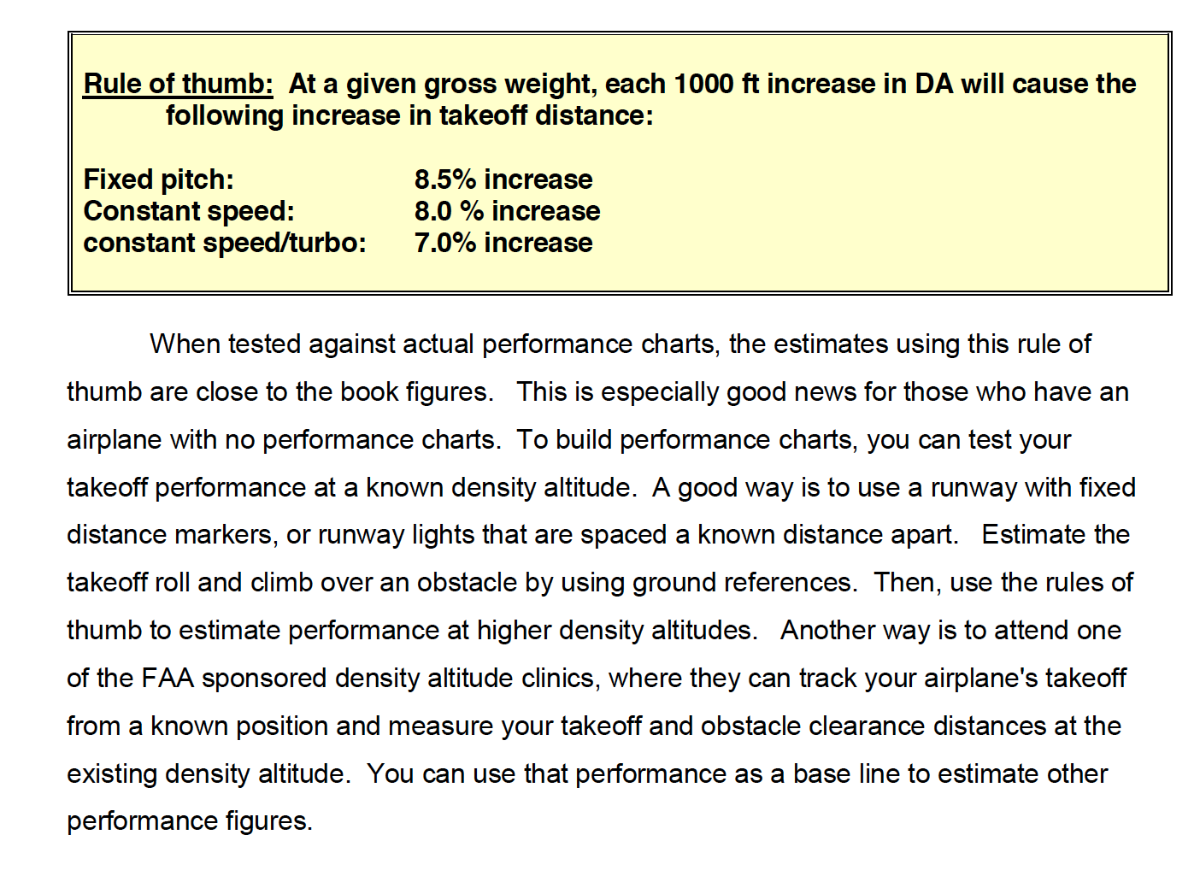

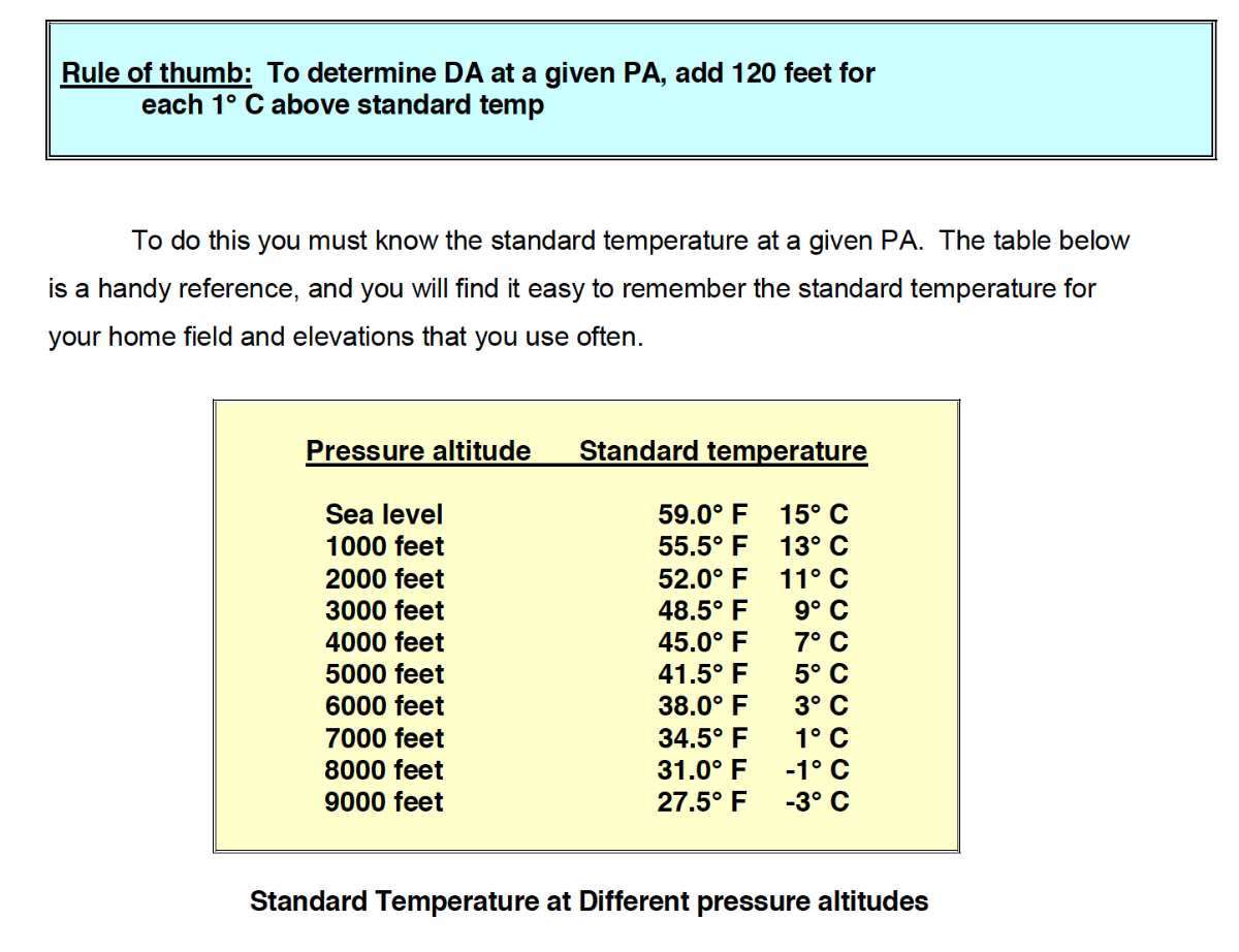

Garfly Posted March 30, 2024 Posted March 30, 2024 I like this article on the subject of DA / Aircraft Performance: DA EFFECTS ON PERF..pdfFetching info... A few highlights: (screen shots - click for full rez) 1 1

poteroo Posted April 21, 2024 Posted April 21, 2024 The take-off, even @ MTOW, used to be less of a problem in PNG ops because most strip's had significant slope. 5 - 10% was usual. But, there was a climb limit for most fully loaded aircraft. I think it was about 6% and was shown on our PK charts. It became a worry if you got airborne ok, but then needed to climb to perhaps 4000ft higher to get through a ' gap ' We used a rule of thumb to add 3000ft to our pressure altitude to calculate DA. 1 3
