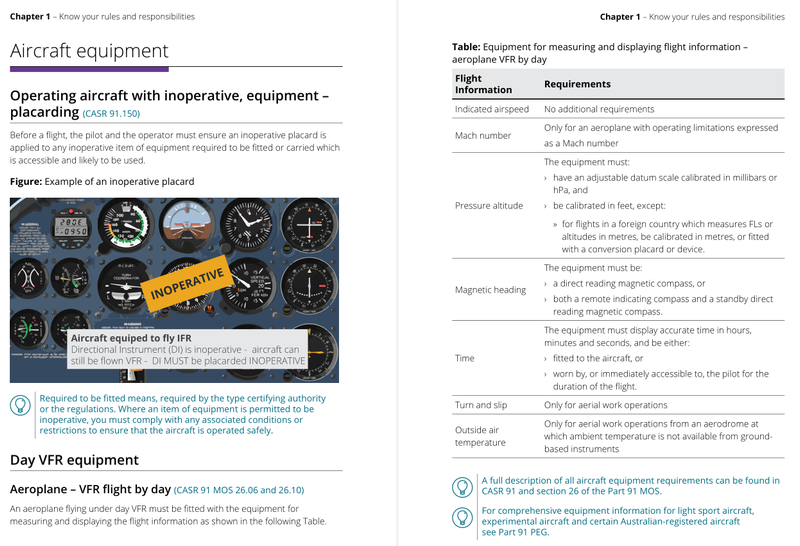

RFguy Posted April 1, 2024 Posted April 1, 2024 it's still minimum VFR equipment Day VFR equipment Aeroplane – VFR flight by day (CASR 91 MOS 26.06 and 26.10) An aeroplane flying under day VFR must be fitted with the equipment for measuring and displaying the flight information as shown in the following Table. VFRG version 7.1 1

Deano747 Posted April 1, 2024 Posted April 1, 2024 On 01/04/2024 at 6:28 AM, RFguy said: it's still minimum VFR equipment Day VFR equipment Aeroplane – VFR flight by day (CASR 91 MOS 26.06 and 26.10) An aeroplane flying under day VFR must be fitted with the equipment for measuring and displaying the flight information as shown in the following Table. Expand That requirement is from table 19 of the VFRG and quite correct, but MOS 26.13 on page 147 of the VFRG gives you some wiggle room depending on your certification. "Application – VFR flight requirements do not apply to certain light sport aircraft (MOS 26.13) Light sport aircraft for which a special certificate of airworthiness has been issued and is in force under CASR 21.186, or for which an experimental certificate has been issued and is in force under CASR 21.191, the equipment standards listed in Table 19 and Table 20 do not apply if the aircraft is fitted with equipment which provides a pilot with the same flight and navigation information." I don't know what your 19-XXXX type is but can be a LSA.
