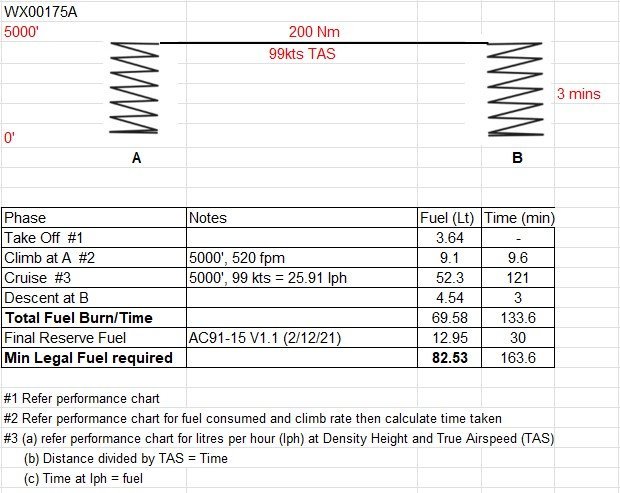

facthunter Posted May 17, 2024 Posted May 17, 2024 Turbs, your info would only apply in still air. Distance / GROUNDSPED = time. Nev
facthunter Posted May 18, 2024 Posted May 18, 2024 Groundspeed x time equals distance covered.. (to put it another way.) Nev
turboplanner Posted May 18, 2024 Posted May 18, 2024 Anyone else care to share how they do these P&O calculations?
skippydiesel Posted May 19, 2024 Author Posted May 19, 2024 On 17/05/2024 at 3:37 AM, facthunter said: Turbs, your info would only apply in still air. Distance / GROUNDSPED = time. Nev Expand If making crude comparison of efficiency, can only use still air, unless aircraft being studied fly exactly same alt/track. Any other comparison will require sophisticated measuring equipment, so that variables can be adequately accommodated or removed. Thats why I like competitions, for obtaining unbiased third party data. 1
skippydiesel Posted May 19, 2024 Author Posted May 19, 2024 On 18/05/2024 at 10:15 AM, turboplanner said: Anyone else care to share how they do these P&O calculations? Expand The only P&O I know, is a shipping line 😈 1

turboplanner Posted May 19, 2024 Posted May 19, 2024 On 19/05/2024 at 2:33 AM, skippydiesel said: The only P&O I know, is a shipping line 😈 Expand I'm beginning to think RA have missed out on teaching it. Interesting that the Instructors are quiet as mice, but they have to sum up whether not teaching it constitutes a reasonably forseeable risk.
facthunter Posted May 19, 2024 Posted May 19, 2024 So now groundspeed is not important when planning fuel etc??? Nev 1
