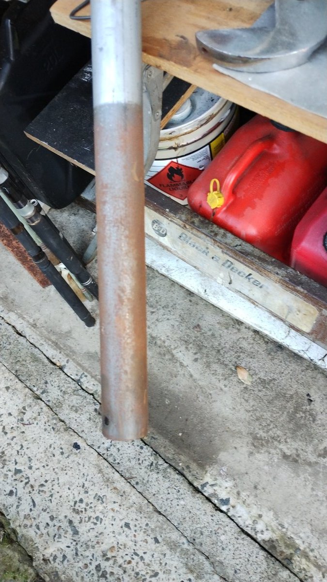

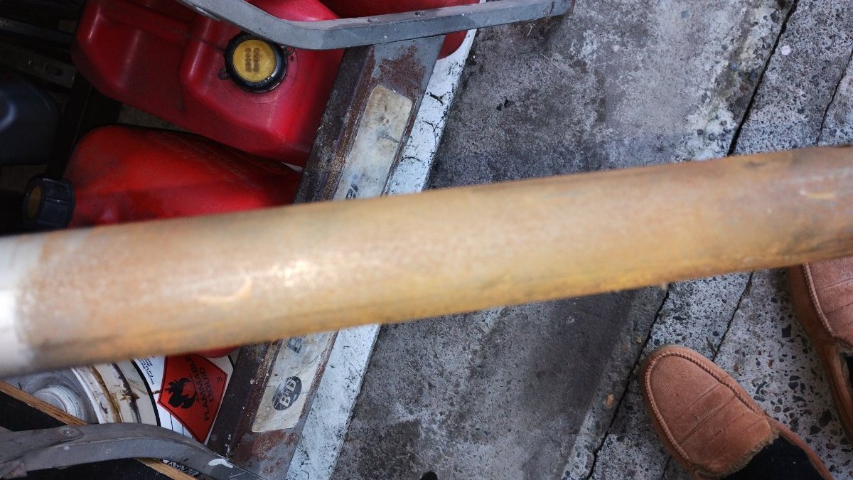

Peasant_Pilot Posted April 25, 2024 Posted April 25, 2024 Have you got a photo of the front gear leg? @GolfWhiskeyHotel Cheers Rob 1
spacesailor Posted April 25, 2024 Posted April 25, 2024 Because, those legs do bend easily, and that wear , plus the rusting on that area . Is a known problem . It's only a tiny aircraft , & I suspect the leg could be made just a little stronger. After a few years of having a ' training wheel ' at the front I was intending to change the ' Hummelbird ' to a conventional tail dagger, eliminating the nose wheel problem. spacesailor
