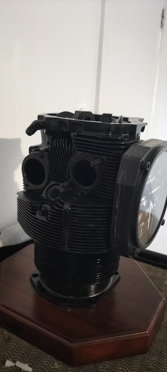

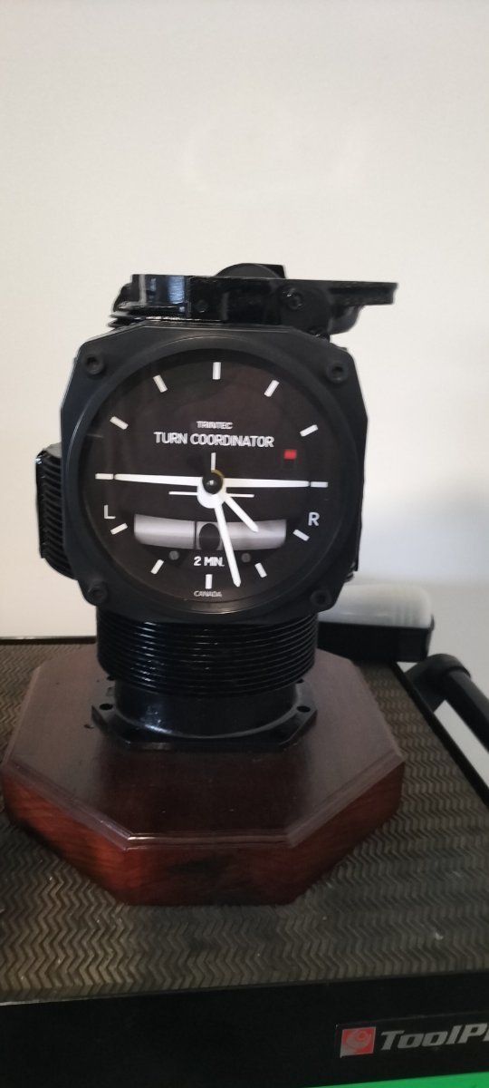

BrendAn Posted May 28 Share Posted May 28 On 27/05/2024 at 10:17 AM, facthunter said: Quite a few Lycoming cylinders are NITRIDED. Nev My Lycoming clock doesn't burn a drop of oil. It is timed out or on depending how you look at it 😁 1 1 Link to comment Share on other sites More sharing options...
BrendAn Posted May 28 Share Posted May 28 Just now, BrendAn said: My Lycoming clock doesn't burn a drop of oil. It is timed out or on depending how you look at it 😁 1 Link to comment Share on other sites More sharing options...
