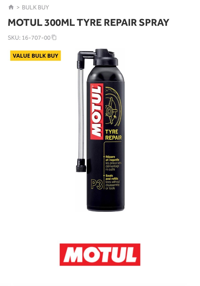

Blueadventures Posted June 2 Share Posted June 2 I carry two of these, they are perfect for tubed tyres. The best in my opinion as does work; as I say on tyres with tubes inside. Cheers 1 1 Link to comment Share on other sites More sharing options...

pmccarthy Posted June 2 Share Posted June 2 8 hours ago, Freizeitpilot said: Thx PMc - as a result of this experience, do you carry anything now ? Yes, one of those instant repair cans mentioned above. And the correct spanner and Allen key to get the brake and wheel off and on, in case the goop can doesn’t work. I carry a small pump. And keep meaning to get a spare tube. But my solution back then was to fit much stronger tyres, went from 4 ply (I think) to something much better and had no more trouble. 1 1 Link to comment Share on other sites More sharing options...
Blueadventures Posted June 2 Share Posted June 2 8 hours ago, Freizeitpilot said: Thx PMc - as a result of this experience, do you carry anything now ? For info; In addition to the cans of P3 above I carry the necessary tools to remove the wheel and spare tube (two tubes on distant trips) with a Peter Anson jack and a hand pump. I also replace tyres at 5 years. Have not had a flat to date; but ready. I have been able to assist other flyers with the pump and also one of my tubes. If I got a thorn puncture I would check type internal for the thorn etc and fit a new tube. Have some patches as well but new tube best. A good mate has used the P3 a number of times due to the three spike thorns and it works great. You need to be as self sufficient as possible; even having spares at your hangar so when needed they are available. When you need an item it can be out of stock at times. 2 Link to comment Share on other sites More sharing options...

skippydiesel Posted June 3 Share Posted June 3 (edited) MOTUL Looking for informed recommendations?????? Motul tyre repair seems to come comes in pack size 300, 400 & 500 ml ($20-$30). Then there are the competitors eg IPON, Michelin, Holts, SCA, Valvoline - starting as low as $10. My aircraft has 5.00-5 tyres. Edited June 3 by skippydiesel Link to comment Share on other sites More sharing options...

skippydiesel Posted June 3 Share Posted June 3 Hi Nev - Just trying to get some experienced comment on a brand/product (Motel P3) being promoted (intentionally or unintentionally). Odd that so often the promoters go quiet, when a person asks for a bit more detail.😈 Link to comment Share on other sites More sharing options...

skippydiesel Posted June 4 Share Posted June 4 Forum conversation waning - need something to heat the blood. The Motul, emergency tyre repair range has been prominent in this conversation, without a shred of acumpening evidence to encourage a significant investment ($30) by the discerning (tight arse) purchaser.💨 The products attractive packaging (red & gold on a black background) is certainly eye catching, along with the mysterious a slightly milatristice name (P3) and the promotional videos, have the pong of a talented marketing team.😎 Underwhelmed by the astonishing number (0) of factual reviews for Motul, never-the less impressed by the potential of such a product, that might just get me & my aircraft from some desolate country strip, to a more favorable (help/workshop) airfield, I have decided to make the astonishingly costly investment, by purchasing the Holts equivalent product. I like the mid level pricing ($26) larger volume of effective product (400 ml - more bang for the buck?) attractive packaging and that I can pick it up (with a discount) from my local REPCO next time I am in there.😈 1 Link to comment Share on other sites More sharing options...
Freizeitpilot Posted June 5 Author Share Posted June 5 Thanks to all forum contributors to this topic. It appears that the latex-based 'goo' is a satisfactory low weight solution for emergency situations when you are out in the boonies, and hopefully you can avoid removing the tyre from the A/C. I've read reviews (mostly motorcycling) for the various brands of goo, and its a mixed bag. Rather than brand vs brand, its a case of sometimes it works very well, and other times it doesn't. For ~ $30, and <500grams, its reasonable insurance against a significant P in the A. 1 Link to comment Share on other sites More sharing options...
skippydiesel Posted June 5 Share Posted June 5 Hi Freizeitpilot, Can't help myself - just have to prod the lion. "Thanks to all forum contributors to this topic." Whaaat ??? - I suspect all paid promoters of Motul (😜) All that is ground based ("mostly motorcycle" ) does not necessarily translate to being a satisfactory aircraft product. After application, these emergency tyre repair/get you home products, require a number of kilometres be driven - presumably to distribute the material around the inside of the tube/tyre and possibly to encourage/speed setting, by being heated. If used in a small (5.00 -5) aircraft tyre, the distance driven will likly be taxi & take-off - how many clicks/ will this be sufficient???. Take-off will be followed by the tyre stopping rotation and cooling rapidly. What might be the result???? Blob of goo settling to the bottom of the tyre ??? On landing, will the tyre be sufficiently inflated to keep the rim of the surface??? Will the goo cause a wildly out of balance wheel/ severe vibration??? All a tad speculative/experimental don't you think???😈 Link to comment Share on other sites More sharing options...
Freizeitpilot Posted June 5 Author Share Posted June 5 OK, the lion has been prodded. I thank the forum contributors for giving up their time to respond to my query and sharing their experience. I call it politeness. "never-the less impressed by the potential of such a product, that might just get me & my aircraft from some desolate country strip, to a more favorable (help/workshop) airfield, I have decided to make the astonishingly costly investment, by purchasing the Holts equivalent product" I understood from your previous comment that you were happy enough to experiment with a tyre repair product on yourself, with all the unknowns thrown in. ....and I don't think that a single contributor suggesting a random branded product they may have chosen to carry with them in their a/c, paints all as "paid promoters of Motul". Separately, I will also be considering higher ply tyres. That's enough from me on this topic, but am certainly still interested in other peoples experiences with managing 'away' punctures. 1 Link to comment Share on other sites More sharing options...
skippydiesel Posted June 5 Share Posted June 5 Without a doubt a Gentleman "I understood from your previous comment that you were happy ..." hmmmm! "happy"? would have liked to get more, from those who have already taken the risk (if indeed they have and this is not just second hand theorising)"..........enough to experiment with a tyre repair product on yourself," point of clarification; will not be applying to any part of my anatomy😎 "......am certainly still interested in other peoples experiences with managing 'away' punctures." me too. As indicated will be carrying a bottle/applicator of the Holts magic potion - the alternative - a pump/spare tube/tools/jack & patches, which I may also carry until such time that the mechanic in a bottle is a proven solution. As is pointed out earlier - I am fairly confident that, these products will allow for TO but what of the landing some time later? not so sure. 😈 Link to comment Share on other sites More sharing options...
