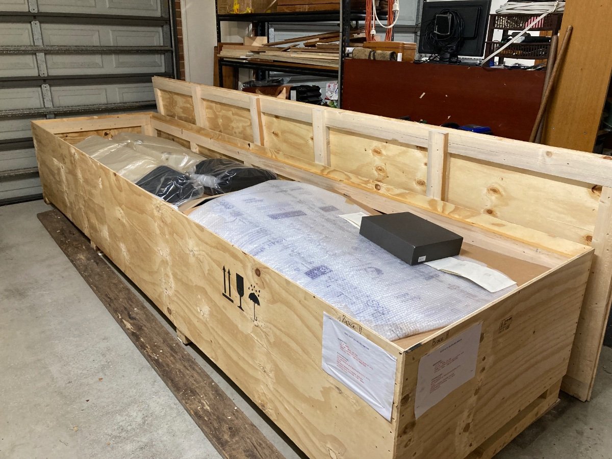

sfGnome Posted June 14, 2024 Posted June 14, 2024 Well, look what just landed in my garage… Yep, I’m building a Ventura too (hi Christin! Bruce here). I was watching Grand Designs last night, and the general theme of that episode was that the builder was so focussed on enjoying the build that she wasn’t at all worried about when she was going to finish. I think I can identify with that. 😛 2 1
