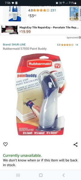

Christin Posted June 14 Author Share Posted June 14 Something like that? 1 Link to comment Share on other sites More sharing options...
Christin Posted June 14 Author Share Posted June 14 Something like this? Link to comment Share on other sites More sharing options...
Christin Posted June 14 Author Share Posted June 14 Oh sorry, double post Link to comment Share on other sites More sharing options...
facthunter Posted June 15 Share Posted June 15 Being thick wouldn't be a good thing would it where rivets are involved? Nev Link to comment Share on other sites More sharing options...
