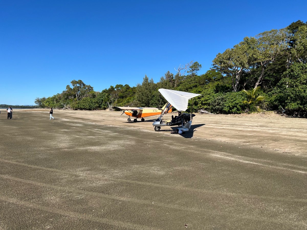

Blueadventures Posted June 17 Posted June 17 This is the SavXL that regularly lands on beach that I mentioned in pm. Cheers
