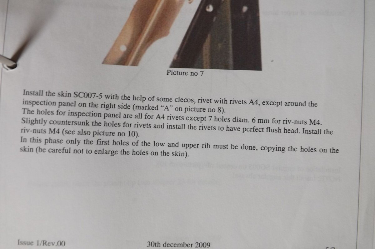

sfGnome Posted August 30 Posted August 30 OK, a question for the Sav/Ventura builders out there (the aspect I'm about to query is the same for both builds as far as I can see). On the side of the fin is an access panel, held in place by rivnuts. Between the rivnuts are standard rivets (ie rivnut, rivet, rivnut, rivet, etc). Now, as these all sit proud of the tail skin, this means that the access panel will likewise be sitting away from the tail by a mm or so. What's more, as the rivnuts are slightly thinner than the rivets, this means that the panel will scallop as it passes over the rivets. Is this a problem, or am I just worrying too much? Should I use c'sunk rivets under the access panel, or is it ok as it (appears to be) designed?
IBob Posted August 30 Posted August 30 (edited) The Savannah manual calls for countersunk A4 rivets fitted flush there. Edited August 30 by IBob
sfGnome Posted August 31 Posted August 31 1 hour ago, IBob said: The Savannah manual calls for countersunk A4 rivets fitted flush there. Thanks. The Ventura manual (a paragon of brevity), just says "Install the rear top skin UV026 and then the nose skin UV002". That's it. No mention of the rivnuts or countersinking or any such useful advice. In fact, you have to look forward to the much later chapter where the tail is attached to the fuselage to see a picture where it is clear that there must be rivnuts... 🙄
