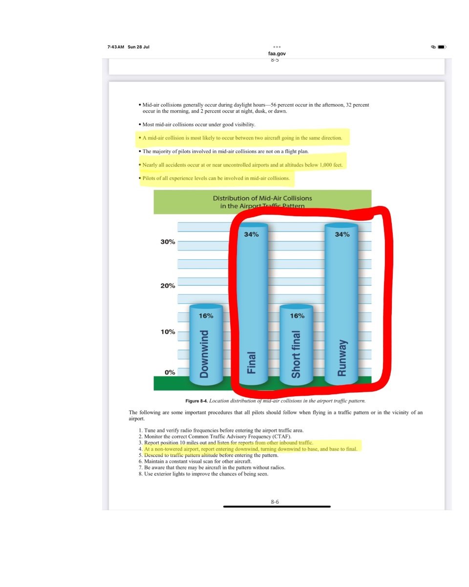

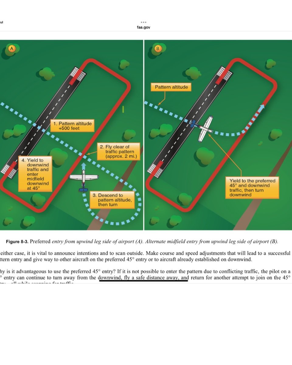

Mike Gearon Posted July 27 Author Share Posted July 27 On 25/7/2024 at 2:35 PM, Deano747 said: Certainly is in the US. All turns in the vicinity of the circuit are to be made in the circuit direction. Stops airplanes flying in opposite directions on the 'dead' side. I was trained in the USA. I’ve just been trying to google “pattern” because USA uses this in place of circuit. So, googled pattern, directions of turns dead side. Gave up in the finish but did find this. It’s a turn in the wrong direction. Then I found the discussion below where the FAA was quite responsive to the ambiguity in the depiction and FAA Regs. FAA have all turns within the vicinity of the airport to the left unless specified. The turn to the right before left pattern is considered to be outside the ‘vicinity’ of the airport. Also found the statistics in that graph that show the least number of accidents are downwind. It’s quite annoying when statistics don’t agree with one’s hypothesis. However, downwind calls are made in USA. Downwind calls are probably not going to be made in Australia unless the PIC is situationally aware of conflict or sticking to the old 3 calls in circuit method. So, our Australian stats may be different. Reference to that article here…….https://www.aviationsafetymagazine.com/airmanship/traffic-pattern-entries/ Note….. I had coffee yesterday with another pilot and tales of close conflict downwind due to lack of downwind call. I also heard that at some flying schools instructors have been berated for making downwind calls “unnecessarily”. I think that’s at the crux of problems. If the instructor feels unable to make downwind calls it certainly isn’t going to be instilled in the students. I’ll return to the point I’ve made previously where an instructor at a local airport called his o’clock position to my aircraft downwind as a workaround to making downwind calls. That’s happened a number of times Link to comment Share on other sites More sharing options...
