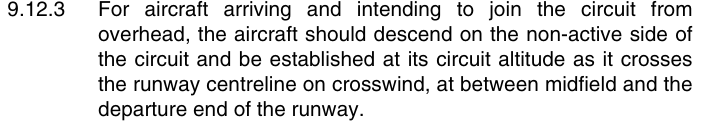

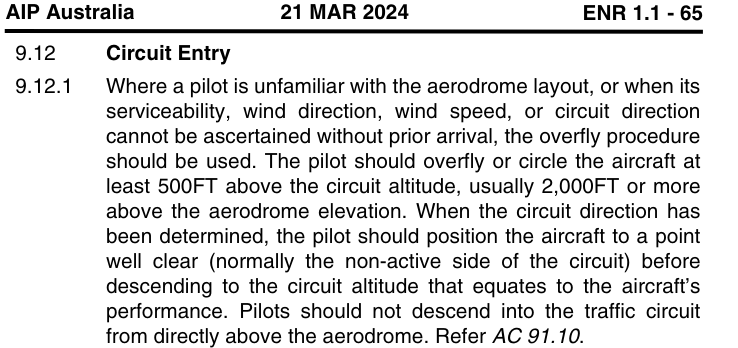

Bosi72 Posted June 21 Share Posted June 21 (edited) AIP ENR 1.1-65 para 9.12.3 "joining overhead" AIP ENR 1.1-57 para 9.1.14 "radio calls" ERSA for specific aerodrome procedure https://www.airservicesaustralia.com/aip/aip.asp?pg=20&vdate=13JUN2024&ver=1 Edited June 21 by Bosi72 Link to comment Share on other sites More sharing options...

skippydiesel Posted June 22 Share Posted June 22 1 hour ago, kgwilson said: Joining overhead or overhead join/re-join has been a commonly known and documented procedure since I first flew in the mid 1970s You live and learn - still don't see how you can" join overhead" from 500ft plus over the circuit height. I do an overhead call for almost every airfield I land at but its a position call, followed by "joining X wind for runway ?????" 1 Link to comment Share on other sites More sharing options...
aro Posted June 22 Share Posted June 22 20 odd years ago when I was training, the procedure was to join crosswind over the departure end of the runway. This has the advantage that if one aircraft joins for 18 and another for 36, they are separated and have time to figure things out before there is a risk of collision. For whatever reason, CASA decided to modify the procedures so you joined midfield (or maybe 2/3 of the way down the runway?) I don't remember whether it was a specific recommendation, but people started referring to "joining midfield crosswind" because it was in a different place to the previous "joining crosswind". I'm pretty sure the overhead join is just another name for what Australia calls midfield crosswind... because you join overhead the field, rather than on downwind etc. Link to comment Share on other sites More sharing options...
facthunter Posted June 22 Share Posted June 22 There's a crosswind leg and a midfield process which includes a descent to circuit height by the time you are on downwind leg. I can't see why you'd want to risk confusing the two. To do the minimum sized circuit you'd climb on the runway extended line to 500FT and then continue the Climb 1000 ft agl to turn downwind at the distance from the runway that suites you. Nev Link to comment Share on other sites More sharing options...
aro Posted June 22 Share Posted June 22 25 minutes ago, facthunter said: a midfield process which includes a descent to circuit height by the time you are on downwind leg. Not in the last 20 years at least... You are supposed to descend on the dead side (or non-active side if you prefer) and be at circuit height before you cross the runway and join the circuit. Descending into traffic on the downwind leg is a no-no. Among other things, it is much easier to see the traffic you are supposed to avoid if you are not above them. Link to comment Share on other sites More sharing options...

aro Posted June 22 Share Posted June 22 1 minute ago, facthunter said: How do you get a look at the windsock and the general layout IF you don't have a look from a safe heigh clear of other circuit traffic.? Overfly at 1500 AGL (or 2000 AGL if there might be high speed traffic doing 1500' circuits.) Check the windsock, determine which runway to use. Descend to circuit height on the dead (i.e. non-active) side. Join the circuit at circuit height. This is pretty basic stuff - anyone post area-solo stage should know it. 1 Link to comment Share on other sites More sharing options...

aro Posted June 22 Share Posted June 22 9 minutes ago, facthunter said: I've done a lot off Flying in general and instructed in GA and AUF/RAA How long ago? This procedure is exactly what is depicted in the diagram from CASA in a previous post. It is what has been taught for decades. It doesn't seem clumsy to me... what does seem clumsy is pilots who are in the circuit, but not yet at circuit height and are descending into circuit traffic. 1 Link to comment Share on other sites More sharing options...
facthunter Posted June 22 Share Posted June 22 You don't seem to be able to think this out in your head. The quickest and most simple move from overhead is to descend midfield and reach circuit height before the downwind leg IF you can't do that go enough distance to DO the descent where it's safe. Dead side or even a bit further depending on the amount of traffic. That will take extra time and manoeuvring than you would doing it the way I suggest. This way of entering the circuit is not the Most common way as I've explained. If you have good radio communication for example and the aerodrome is familiar to you. Nev Link to comment Share on other sites More sharing options...
aro Posted June 22 Share Posted June 22 I can think it through, but the rules say different. Here it is straight from AIP: Pilots should not descend into the traffic circuit from directly above the aerodrome... ... the aircraft should descend on the non-active side of the circuit and be established at circuit altitude as it crosses the runway centreline on crosswind 1 Link to comment Share on other sites More sharing options...
