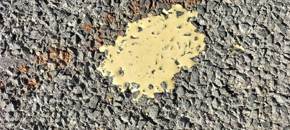

BrendAn Posted June 24 Posted June 24 Look at this crap my jab spits out. It doesn't use much oil at all but must make plenty of condensation. 1
Red Posted June 25 Author Posted June 25 Gordon Bennett!!! what oil temperature do you run at? Or is this a joke?
BrendAn Posted June 25 Posted June 25 1 hour ago, Red said: Gordon Bennett!!! what oil temperature do you run at? Or is this a joke? 90c
Red Posted June 25 Author Posted June 25 (edited) A nice temperature then. Is this coming from the breather after the catch tank?, I guess if its very high humidity and there is no sign of the same high water contamination at the dipstick then its not too much or a worry and could be forming in the catch tank. Knowing how prone to bore corrosion the jabs are (unless its a gen 4) then Id want to get to the bottom of it. P.S. I've never had anything near that bad spat out by my Jab or any other air cooled engine Edited June 25 by Red
skippydiesel Posted June 25 Posted June 25 Rotax recomend oil temps reach above 100C for a sustained period, specifically to drive of water & other volatile contaminants. I aim for mid to high 90C in Cruise and hope to see over 100C during climb out. 90C is far to low.
Red Posted June 25 Author Posted June 25 90C is a good operating temp for a Jab on an XAir, the engine is exposed and the sensor will be under reading actual temperature
skippydiesel Posted June 25 Posted June 25 25 minutes ago, Red said: 90C is a good operating temp for a Jab on an XAir, the engine is exposed and the sensor will be under reading actual temperature Not if you get calf scour (water/oil emulsions) coming out of the crankcase breather. Something needs to be done to raise the oil temp. It's quite likly that the inside of that engine is coated in a thick film of "gunk" - Leave it long enough and it will reduce the flow of oil through distribution galleries.
BrendAn Posted June 25 Posted June 25 2 hours ago, Red said: A nice temperature then. Is this coming from the breather after the catch tank?, I guess if its very high humidity and there is no sign of the same high water contamination at the dipstick then its not too much or a worry and could be forming in the catch tank. Knowing how prone to bore corrosion the jabs are (unless its a gen 4) then Id want to get to the bottom of it. P.S. I've never had anything near that bad spat out by my Jab or any other air cooled engine oil in the engine is spotless. it only makes this emulsion after more than an hours flying. i run it weekly because number 2 may have a bit of pitting. 80/60 which is the bottom limit for a 2200 leakdown but still serviceable. the other 3 are 80/70.
BrendAn Posted June 25 Posted June 25 1 hour ago, skippydiesel said: Not if you get calf scour (water/oil emulsions) coming out of the crankcase breather. Something needs to be done to raise the oil temp. It's quite likly that the inside of that engine is coated in a thick film of "gunk" - Leave it long enough and it will reduce the flow of oil through distribution galleries. its not in the engine. oil is perfect and it hardly uses any. it used to have an oil cooler that was a lot bigger than the one on it now.
