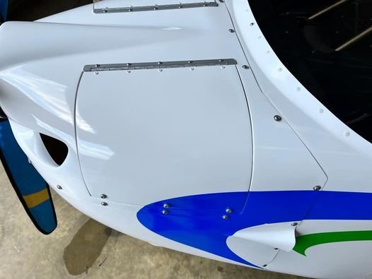

Col Posted June 24, 2024 Posted June 24, 2024 I've contemplated this option; hatch each side (not sure where I saw this pic), but my fibreglassing skills are not up to it. 3 1

Red Posted June 24, 2024 Author Posted June 24, 2024 Thanks Marty, thats's just the sort of thing ...big enough to get yer hand through Col. Another one to ponder, that would give excellent access for a looksie at most of the top half of the engine...hmm
