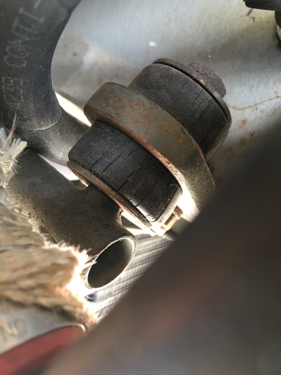

jackc Posted June 24 Share Posted June 24 A LAME OK’ed these engine mounts on my 912 powered Aeropup. 2 Link to comment Share on other sites More sharing options...
Area-51 Posted June 24 Share Posted June 24 (edited) It depends upon the material's chemical specification of the mount. Rubber, Nylon, Neoprene, Polyurethane, EPDM... They all respond differently to different types of lubricants; Mineral Oil Derivative, Synthetic Oil Derivative, Silicone Based Grease, Rubber Grease, Vegetable Plant Oil Derivative, Carbon Graphite Powder, Chalk Rock Powder. Best to always consult a Materials Specification chart to see what substances and exposure times have a Severe Moderate or Minor affect. For fitting flexible rubber type components baby powder makes life easy; and everything will smell like fresh nappies! Boot polish works wonders on nylon plastic rubber derivatives; stops them drying out and cracking Edited June 24 by Area-51 1 Link to comment Share on other sites More sharing options...
BrendAn Posted June 24 Share Posted June 24 57 minutes ago, jackc said: A LAME OK’ed these engine mounts on my 912 powered Aeropup. i don't know about them. if they were mine i would replace them. pretty ugly. Link to comment Share on other sites More sharing options...
jackc Posted June 24 Share Posted June 24 2 minutes ago, BrendAn said: i don't know about them. if they were mine i would replace them. pretty ugly. Replaced them all, nuts as well. I did it all as part of the 5 year rubber replacement among other things the LAME did not do…… Link to comment Share on other sites More sharing options...
BrendAn Posted June 24 Share Posted June 24 Just now, jackc said: Replaced them all, nuts as well. I did it all as part of the 5 year rubber replacement among other things the LAME did not do…… well done jack. glad you changed the nuts too, they were not to flash either. Link to comment Share on other sites More sharing options...
