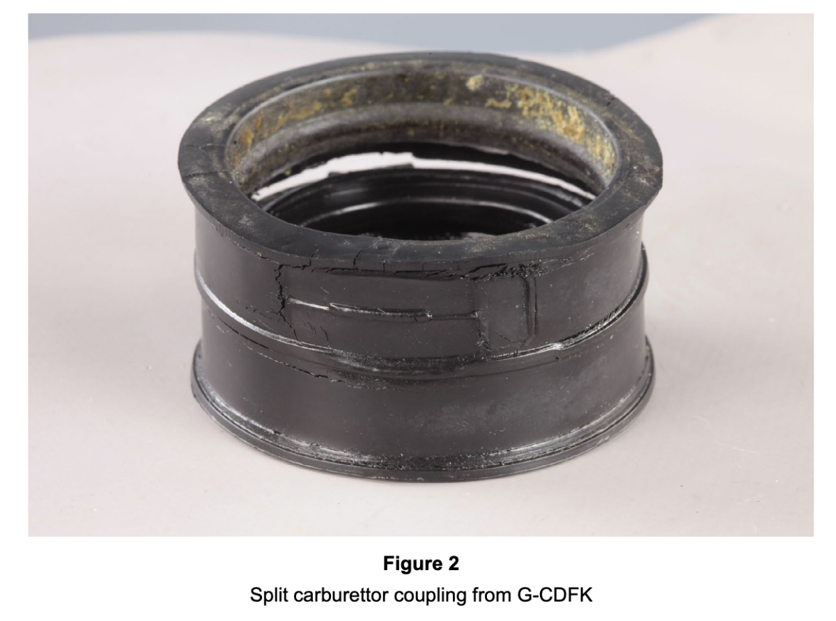

Garfly Posted July 7, 2024 Posted July 7, 2024 Jabiru_UL-450_G-CDFK_08-24.pdfFetching info... Probable culprit: As mentioned by The Flying Reporter here: https://www.youtube.com/watch?v=NA0W0YHwdyY 1

BrendAn Posted July 8, 2024 Posted July 8, 2024 On 08/07/2024 at 12:48 AM, facthunter said: It doesn't take much to ruin your day. . That part is too unreliable to be on a plane. A backfire could cause that. Nev Expand nothing wrong with them if they are changed out occasionally. they think that one has been there since 2006. or do you have a list of incidents where carb sockets have failed on jabiru engines. stick to the facts like you always say you do. 1
facthunter Posted July 8, 2024 Posted July 8, 2024 Be Nice. What is a non fact on my post? The equivalent on many motorbikes is far more substantial. Ideally the carburettor would be supported by more than a rubber sleeve...Nev 1
skippydiesel Posted July 8, 2024 Posted July 8, 2024 (edited) Interesting. If the Jab carb socket was new in 2006 and it had been a Rotax socket, it would have been replaced 3 times by now (assuming adherence to recommended practise) and due for another new one in a coupe of years. Edited July 8, 2024 by skippydiesel 1
facthunter Posted July 8, 2024 Posted July 8, 2024 Of course it's good to replace them at specified periods. I just don't think the design is good enough for aircraft practice. The weight should be taken at other places as well. I doubt the scrutineers would allow it on a race car either. Plenty of vibration in reality and potentially to handle on an aircraft. ..Nev 2

BrendAn Posted July 8, 2024 Posted July 8, 2024 On 08/07/2024 at 4:10 AM, facthunter said: Be Nice. What is a non fact on my post? The equivalent on many motorbikes is far more substantial. Ideally the carburettor would be supported by more than a rubber sleeve...Nev Expand I meant what evidence do you have that carb sockets are a problem on aircraft. Think of how many jabiru and Rotax engines are flying around they can't be too bad. Although now I am going to fit a new one on mine. Otherwise your words will haunt me whenever I fly.😁 2 1
facthunter Posted July 8, 2024 Posted July 8, 2024 Few other engines have such an inadequate carburettor attaching set-up. They bolt straight on with a gasket. There's no other way THAT Motorcycle carb can be mounted easily. On the BMW bike it's from the pipe to the aircleaner helps steady it and it's pretty OLD (and cheap) model. Vibrating carburettors with floats can have frothing and flooding issues. Nev 1
BrendAn Posted July 8, 2024 Posted July 8, 2024 On 08/07/2024 at 8:26 AM, facthunter said: Few other engines have such an inadequate carburettor attaching set-up. They bolt straight on with a gasket. There's no other way THAT Motorcycle carb can be mounted easily. On the BMW bike it's from the pipe to the aircleaner helps steady it and it's pretty OLD (and cheap) model. Vibrating carburettors with floats can have frothing and flooding issues. Nev Expand true but my jab has 399 hours on it and there is no mention of problems with the carb socket in the log books since new in 2004. it has no support either. 1
Red Posted July 8, 2024 Posted July 8, 2024 On 08/07/2024 at 9:06 AM, BrendAn said: true but my jab has 399 hours on it and there is no mention of problems with the carb socket in the log books since new in 2004. it has no support either. Expand If you have no airbox and just filters hanging on the carb throats I'd reccomend removing the socket and inspecting at this point Brendan, I took the socket of my new to me Jabiru engine that had just 9 hours on it but years of sitting around waiting for the builder to complete and it was starting to split, they split internally.....it seems to be a quite rare occurence in Jabs but its so easy to remove and check its worth doing on your 100 hour checks imo. Now if it was a Rotax 912 with no airbox...well Ive replaced them on one engine twice in a 1 year and actually had one split half way round and the carb fell right off luckily after landing, Jabs seem far more forgiving in this dept. as Nev mentioned cantilever mounting on a stub of rubber with no support for the other end of the carb is far from ideal, maybe your aircraft has a rigid airbox that end..if so disregard my comment it'll probably last hundreds of hours mounted that way. 1 1
BrendAn Posted July 8, 2024 Posted July 8, 2024 On 08/07/2024 at 8:04 PM, Red said: If you have no airbox and just filters hanging on the carb throats I'd reccomend removing the socket and inspecting at this point Brendan, I took the socket of my new to me Jabiru engine that had just 9 hours on it but years of sitting around waiting for the builder to complete and it was starting to split, they split internally.....it seems to be a quite rare occurence in Jabs but its so easy to remove and check its worth doing on your 100 hour checks imo. Now if it was a Rotax 912 with no airbox...well Ive replaced them on one engine twice in a 1 year and actually had one split half way round and the carb fell right off luckily after landing, Jabs seem far more forgiving in this dept. as Nev mentioned cantilever mounting on a stub of rubber with no support for the other end of the carb is far from ideal, maybe your aircraft has a rigid airbox that end..if so disregard my comment it'll probably last hundreds of hours mounted that way. Expand Mine is good. Took it off and inspected 3 months ago. I am going to replace it anyway. 1
skippydiesel Posted July 8, 2024 Posted July 8, 2024 "Now if it was a Rotax 912 with no airbox...well Ive replaced them on one engine twice in a 1 year and actually had one split half way round and the carb fell right off luckily after landing," Strange Red- I am on my second Rotax 912 ULS. The first with basic conical air filters, no extra carby support, had 900 hrs plus on it - never had a problem. Replaced all rubber at 5 years intervals. New aircraft/Rotax 912 ULS (92 hrs) has air box (carby support). Yet to do a rubber replacement. Interestingly: Had a story from a Europa/Rotax 912 ULS pilot. Carbys fitted basic conical air filters, no additional support. He & his wife (both very experienced pilot/instructors) were flying their newly completed/commission aircraft, when they lost a blade on the CS prop. The out of balance engine attempted to leave the airframe but stopped milliseconds after the prop lost . Aircraft landed in a paddock - no injuries. Such was the violence of the vibration, the whole of the front end of the aircraft had to be rebuilt. Pilot contributed the sudden stop of the engine, to the carburettors seperating from the rubber inlet manifolds. He was certain that he and his wife would have died, had the engine continued its vibration for milliseconds longer and departed the airframe. 1 1

Red Posted July 9, 2024 Posted July 9, 2024 (edited) On 08/07/2024 at 11:36 PM, skippydiesel said: "Now if it was a Rotax 912 with no airbox...well Ive replaced them on one engine twice in a 1 year and actually had one split half way round and the carb fell right off luckily after landing," Strange Red- I am on my second Rotax 912 ULS. The first with basic conical air filters, no extra carby support, had 900 hrs plus on it - never had a problem. Replaced all rubber at 5 years intervals. New aircraft/Rotax 912 ULS (92 hrs) has air box (carby support). Yet to do a rubber replacement. Interestingly: Had a story from a Europa/Rotax 912 ULS pilot. Carbys fitted basic conical air filters, no additional support. He & his wife (both very experienced pilot/instructors) were flying their newly completed/commission aircraft, when they lost a blade on the CS prop. The out of balance engine attempted to leave the airframe but stopped milliseconds after the prop lost . Aircraft landed in a paddock - no injuries. Such was the violence of the vibration, the whole of the front end of the aircraft had to be rebuilt. Pilot contributed the sudden stop of the engine, to the carburettors seperating from the rubber inlet manifolds. He was certain that he and his wife would have died, had the engine continued its vibration for milliseconds longer and departed the airframe. Expand Strange indeed, over here its extremely commonplace to get splits, I think every rotax 912 sans airbox owner I know has mentioned it occuring to them at some point I wonder if climate plays a part?, though I dont see how cold damp conditions could lead to this, especially as the splits always seem to start internally Edited July 9, 2024 by Red 1
skippydiesel Posted July 9, 2024 Posted July 9, 2024 On 09/07/2024 at 6:40 AM, Red said: Strange indeed, over here its extremely commonplace to get splits, I think every rotax 912 sans airbox owner I know has mentioned it occuring to them at some point I wonder if climate plays a part?, though I dont see how cold damp conditions could lead to this, especially as the splits always seem to start internally Expand All doing the 5 year rubber replacement on/close to, time?? The inside of the rubber manifold flange should only be exposed to air/fuel - I know the air is toxic 😎 so could UK fuel somehow have something to do with it??? 1
Red Posted July 9, 2024 Posted July 9, 2024 (edited) On 09/07/2024 at 7:24 AM, skippydiesel said: All doing the 5 year rubber replacement on/close to, time?? The inside of the rubber manifold flange should only be exposed to air/fuel - I know the air is toxic 😎 so could UK fuel somehow have something to do with it??? Expand I can't see it being fuel as it seems to effect engines that were run on various fuels, ethanol free/laced/avgas. I wonder if it could be hot cold cycles..hot when running then left getting cold soaked in hangers'''repeat every flight , quite temperature difference. I don't imagine engines in your part of the world ever see cold part of that cycle. I'm just guessing here. Edited July 9, 2024 by Red 1
