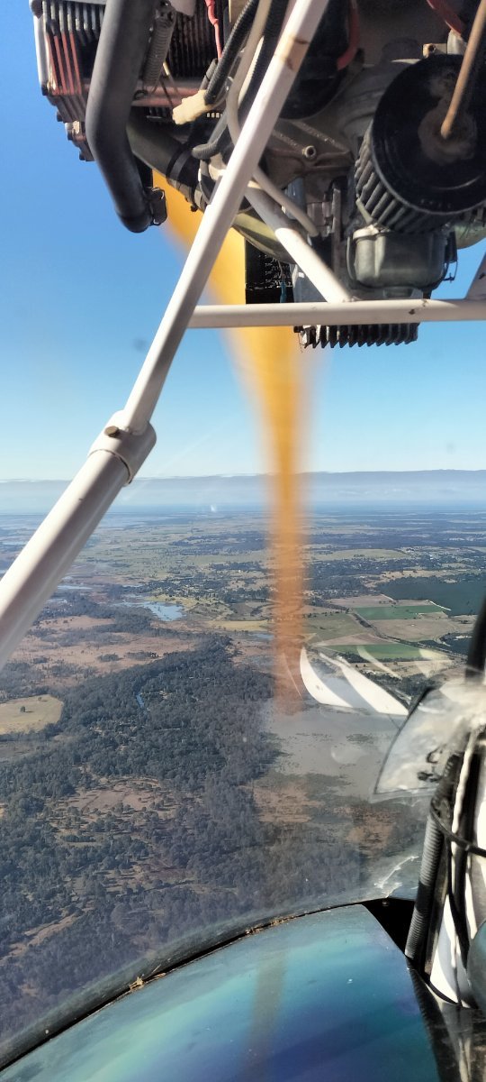

On the xair it's easy to check the carb sockets each preflight. I always have a look at it , but as you can see there is no support apart from the rubber socket.IMG20240706114821.thumb.jpg.70ce0206def3e360fc3b248450d2f679.jpg
Brendan, what is that black round thing with a rod or tube sticking out of its centre that appears to be directly behind the air filter element?
