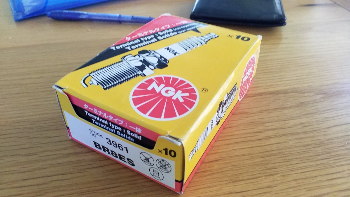

jackc Posted July 27 Share Posted July 27 (edited) 1 hour ago, Tony said: Received this email from Bert Flood: Good morning. There are 2 types of spark plug,dependant on model 14mm MOD 99 -897055 12mm MOD17 -297656 I hope this answers your question. For your reference,the illustrated parts catalogue is available to view at :- Technical documentation | Manuals | Rotax Aircraft Engines (flyrotax.com) Kind regards Adam My motor was one of the last ones produced as a complete assembly 2 years ago. Edited July 27 by jackc Add image 1 Link to comment Share on other sites More sharing options...
