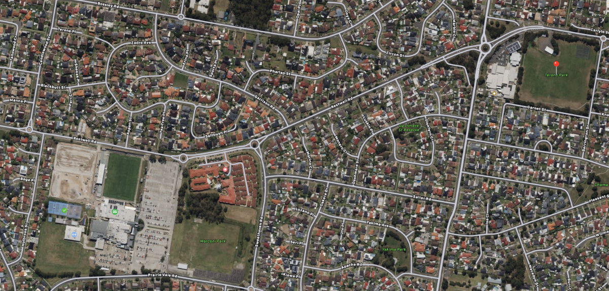

Garfly Posted August 23 Posted August 23 Yes, Terone Park is top-right in this pic, whereas the ARFF WORLD video had zoomed in to the little green patch at the lower left. Interesting that they'd sourced the Mayday call, though. 1
