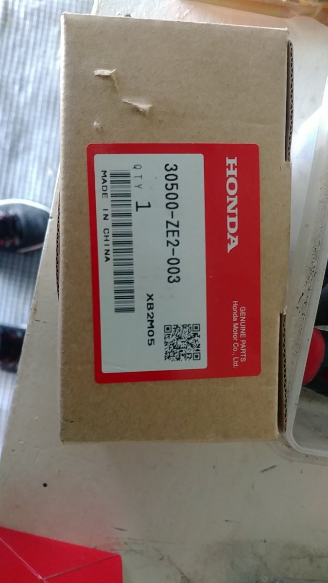

Jabiru Gen 3 uses Honda transistorised coils. They are not pulse magnetos in the traditional sense so you can't hand prop a Jabiru engine as they require 300RPM to activate. Jabiru has these in stock. I replaced both coils on My gen 3 when I found the originals which were Honda copies began misfiring at different times. This manifested in me thinking I had a crook plug or HT lead. With the correct coils the engine runs very sweetly.
See photo of the correct part attached. I tried to source these elsewhere but with freight etc it was cheaper from Jabiru. Note these are for the 3300 6 cylinder engine but I think the coils are the same for the 2200.

That is a different part No to the one supplied by Jabiru. Once I installed the second coil, Honda part No 30500-ZE2-003  my engine has run better than it ever did before

The Jabiru supplied coil has the exact length of copper strand lead and connector to the distributor cap. I noticed that some others have a length of lead which you need to cut to length and install the end connector and push fit rubber cap.
