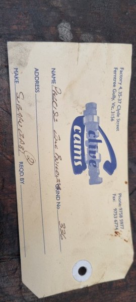

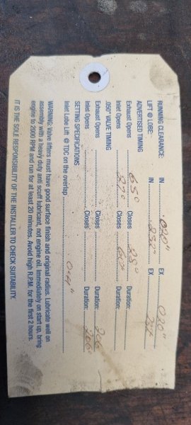

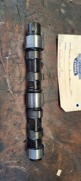

will kirkbride Posted September 13 Posted September 13 Hi. I have a modified EA81 in my Zenith CH750. The wade cam grind is used but was reground by Clive cams who used to be the main guy before Wade was taken over. I have a spare reground cam if you are interested. My engine is much modified with a fuel injection system and crank triggered ignition. Happy to fill you in with any questions you may have. I agree that the engine is getting old now,but has proven to be reliable so far. 1 1
BenG Posted September 14 Author Posted September 14 Hi there will, thanks for the feed back. If you do have a spare I’m interested otherwise I’ll strip one out of engine and send down to Clive cams. They are great to deal with. What is your wot rpm s as I’m wanting to check all this before I go do the change over. My engines currently do 4800 rpm. 1
will kirkbride Posted September 15 Posted September 15 Hi. BenG. My engine does 4600 static. It will rev to 5000 if I let it but I have the prop set so it cruises at around 4500. It is totally different in a gyro of course. I have built 2 engines for gyros. You are restricted by the size of the intake manifold and the port size. I will try to find my spare cam and give you the grind number or the specs if you want to get your own ground. Let me know if you want anything else. Cheers
