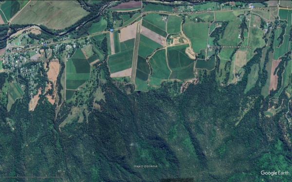

Thruster88 Posted September 9 Share Posted September 9 A messed up go round on a short one way strip. What is a one way strip? OCCURRENCE SUBMITTED TO DETAILS RAAUS: The CFI and instructor were on approach to a one-way private strip in an instructor training exercise. The aircraft bounced upon landing with limited opportunity to recover with election to attempt to go around being unsuccessful. The aircraft clipped the tree tops. 1 Link to comment Share on other sites More sharing options...
pluessy Posted September 9 Share Posted September 9 16 minutes ago, Thruster88 said: What is a one way strip? A landing strip where you land, turn the aircraft around and take off in the direction you came from. Many one way strips have rising ground or other obstacles at one end that can make it impossible to complete a go-around. Look at the topographie of the "Finch Hatton strip", mountain on the S side that you will not outclimb. 1 Link to comment Share on other sites More sharing options...
