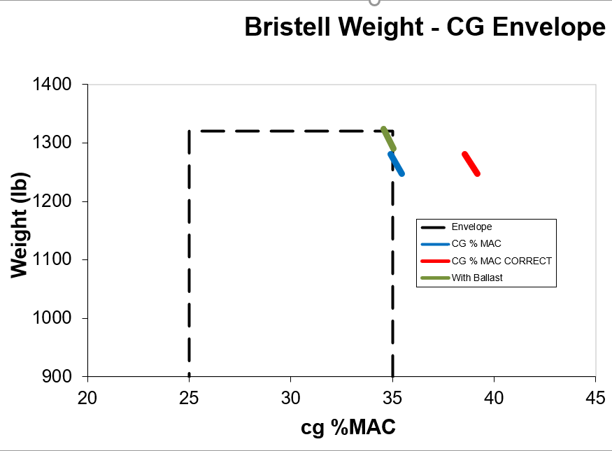

djpacro Posted September 21, 2024 Posted September 21, 2024 CASA's note on 7/8/20 referred only to the change in crew moment arm. Nothing else changed as shown in my diagram here. The blue line was an example from the Bristell manual. The red line is the same example with the correct crew moment arm. The change to the datum (and therefore the limits wrt that datum), it seemed to me, only obfuscated any comparison.
FlyBoy1960 Posted September 21, 2024 Posted September 21, 2024 Nearly any plane ever made will be in the correct weight and balance range of 25% to 35% MAC, it's physics ? if you position the crew so they are at 40% MAC then you will fly very tail heavy and could possibly be uncontrollable. 1
