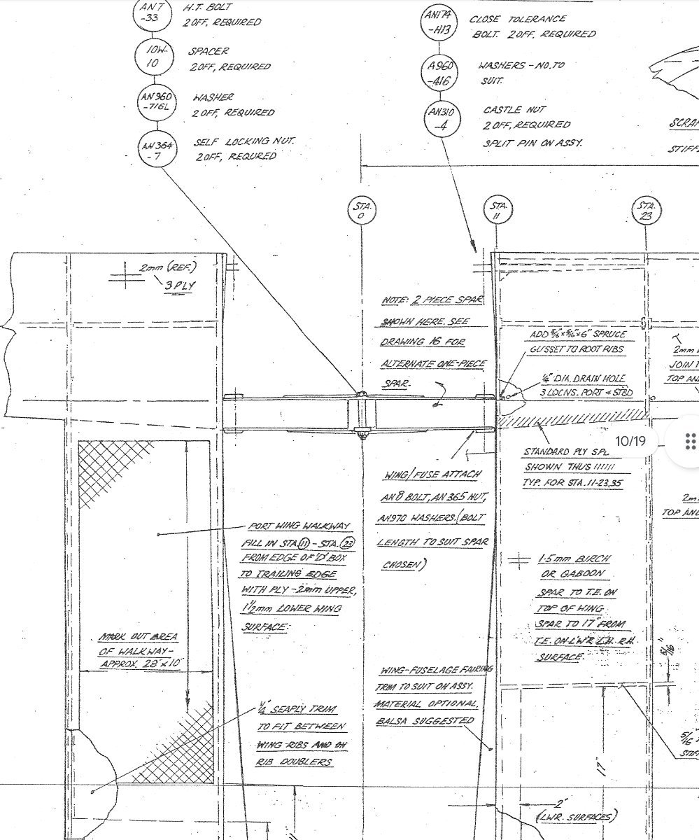

Geoff_H Posted October 14, 2024 Posted October 14, 2024 Has anyone made a trailable Corby Starlet? Folding wings maybe, or even removable wings with a reasonably quick reassembly.
facthunter Posted October 14, 2024 Posted October 14, 2024 Never heard of one. The wing structure is unique on a Corby. Laminated one piece wooden spar. It could maybe be done like a Kittyhawk bolted up from the bottom.. Nev
Thruster88 Posted October 14, 2024 Posted October 14, 2024 Simple folding wind aircraft are usually high wing with struts. Kitfox, Glastar etc. Strut supports wing at all times. Spar has no carry thru. Would not be feasible on a cantilevered wing. Quick remove like the RV12 is an option for cantilever wing types. 1
Geoff_H Posted October 14, 2024 Author Posted October 14, 2024 It appears that there maybe a 2 piece spar option with a joining plate in the middle. I was wondering if anyone had worked out a way to separate it or make some other arrangements for quickly changing the wings. If I bought one I know that I would prefer to trailer it. Geoff
