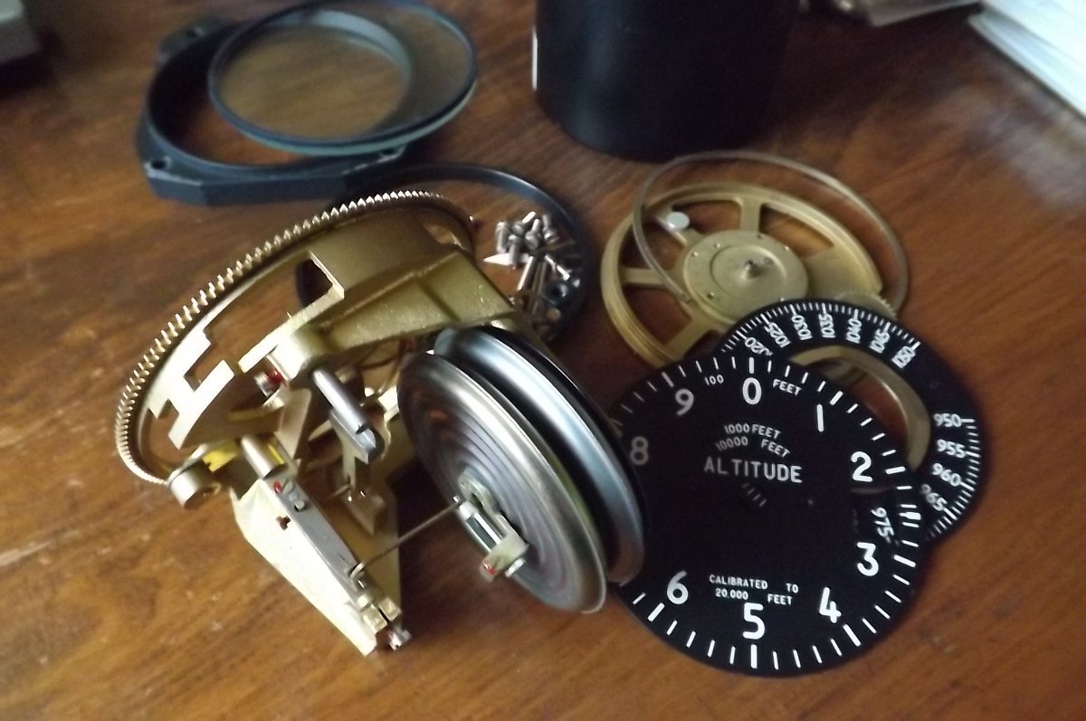

IBob Posted October 15, 2024 Posted October 15, 2024 I had a altimeter fail very gradually: the first indication of that was when I set the QNH correctly preflight , it did not show the correct field elevation. Over a number of days it drifted further and further out. I would guess that one of the two internal bellows or cells sprung a tiny leak, and on inspection it looked as though one of them had not been put through a final plating process. 1
BrendAn Posted October 15, 2024 Author Posted October 15, 2024 30 minutes ago, IBob said: They are amazing instruments when you think how they react to such minute pressure changes. 1

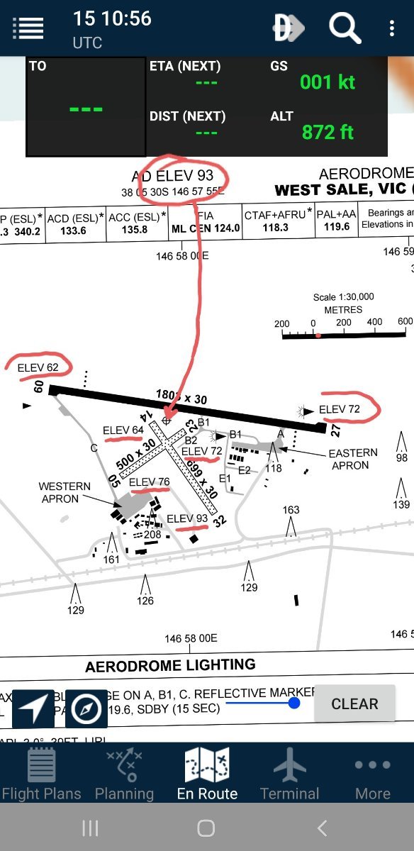

Bosi72 Posted October 15, 2024 Posted October 15, 2024 (edited) On 14/10/2024 at 10:04 PM, BrendAn said: when we are doing preflight checks we always switch to atis and put in the latest qnh . if you are flying out of the same place all the time why not just turn the altimeter to the known height, like outside our hangar it is 130 ft asl. wouldn't that be the same result as the atis advice or am i thinking this wrong. yes you can set altimeter if you know exact elevation of your hangar, and you should be able to confirm accuracy at the thresholds, reference points. Assuming this is in ywsl, I am curious if all elevations are between 62ft and 93ft, are you sure 130ft is right? The main reason for setting qnh from atis/awis is to have everyone's altimeter on the same pressure (elevation). When flying in the levels above 10000ft, everyone is on 1013. Edited October 15, 2024 by Bosi72 1
BrendAn Posted October 16, 2024 Author Posted October 16, 2024 9 hours ago, Bosi72 said: yes you can set altimeter if you know exact elevation of your hangar, and you should be able to confirm accuracy at the thresholds, reference points. Assuming this is in ywsl, I am curious if all elevations are between 62ft and 93ft, are you sure 130ft is right? The main reason for setting qnh from atis/awis is to have everyone's altimeter on the same pressure (elevation). When flying in the levels above 10000ft, everyone is on 1013. I am not sure about your elevations. I thought the western apron was 130 and runway 9 is 90 ft . I had a Dynon panel and a steam gauge and I always set both to the awis qnh. We fly 500 ft circuits at 620 on the altimeter. What have you got for yltv It is 180 ft there.
BrendAn Posted October 16, 2024 Author Posted October 16, 2024 9 hours ago, Bosi72 said: yes you can set altimeter if you know exact elevation of your hangar, and you should be able to confirm accuracy at the thresholds, reference points. Assuming this is in ywsl, I am curious if all elevations are between 62ft and 93ft, are you sure 130ft is right? The main reason for setting qnh from atis/awis is to have everyone's altimeter on the same pressure (elevation). When flying in the levels above 10000ft, everyone is on 1013. Would there be that much difference between the RAAF base and west sale. We use the RAAF base qnh. It's only 10 km away.
BurnieM Posted October 16, 2024 Posted October 16, 2024 From Garmin Pilot; the reference point at East Sale is 23ft and West Sale is 93ft 1

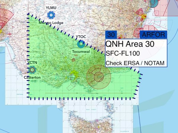

Garfly Posted October 16, 2024 Posted October 16, 2024 (edited) 1 hour ago, BrendAn said: Would there be that much difference between the RAAF base and west sale. We use the RAAF base qnh. It's only 10 km away. Brendan, this is the extent of your local QNH Area as shown in OzRunways (if that's what you were asking about): CLICK FOR FULL REZ: Edited October 16, 2024 by Garfly
BrendAn Posted October 16, 2024 Author Posted October 16, 2024 It covers a large area . More than I thought it would. How can area 30 have one qnh when the weather pattern of eastern Victoria is different to Melbourne and western Vic.

mkennard Posted October 16, 2024 Posted October 16, 2024 10 minutes ago, BrendAn said: It covers a large area . More than I thought it would. How can area 30 have one qnh when the weather pattern of eastern Victoria is different to Melbourne and western Vic. Because unless it's a nice High Pressure system, they do break it up but that gets fun since you have to find the places they are talking about for the boundries and times for the different QNH. 1
Garfly Posted October 16, 2024 Posted October 16, 2024 (edited) 35 minutes ago, BrendAn said: It covers a large area . More than I thought it would. How can area 30 have one qnh when the weather pattern of eastern Victoria is different to Melbourne and western Vic. Yeah, well Area QNH is often an approximation of local QNH at a given time and place. The main aim being that all aircraft are on the same pressure datum to keep clear of each other vertically whilst enroute. But, of course, the Area QNH can't be too far out because we need to avoid terrain as much as each other (below the transition level). So the Area QNH changes regularly to track the changing atmospheric pressure. And yes, you do get the accurate Local QNH by dialling up your known field elevation but that's just for that exact time and that local area. I guess it's good to keep in mind that arriving or overflying aircraft are likely to be on Area QNH (at uncontrolled fields). Edited October 16, 2024 by Garfly 1 2
