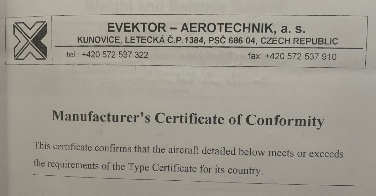

Moneybox Posted October 25, 2024 Posted October 25, 2024 Most Evektor Sportstars are LSA but for some reason this particular aircraft is Type-Certified. It was a Factory Demo model, perhaps that made a difference or was it registered before LSAs came into being? It's a 2004 model.

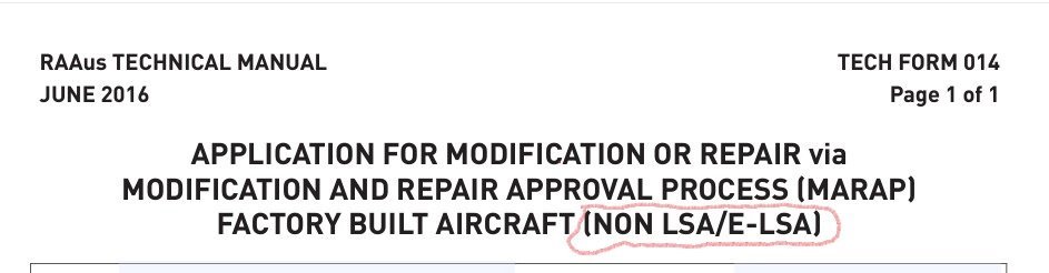

F10 Posted October 27, 2024 Posted October 27, 2024 This seems a bit of a minefield.....What makes sense to me is running an engine on condition, with a 24-rego, with the restrictions of no training, student solos or hire of any kind. RA aircraft are compulsory placarded with "fly at your own risk" after all. However, I understand that you could submit a MARAP, to install a different engine in your 24-rego aircraft. Such as replacing an 80Hp Rotax with a 100Hp Rotax. Now to me, that is strange, as this is a definite significant change to the type certificate? In this case, I think the aircraft should be re- registered as experimental. 1
