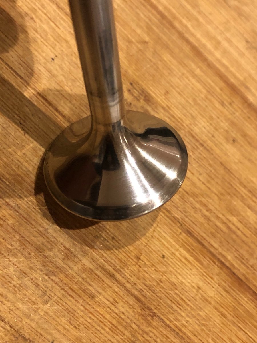

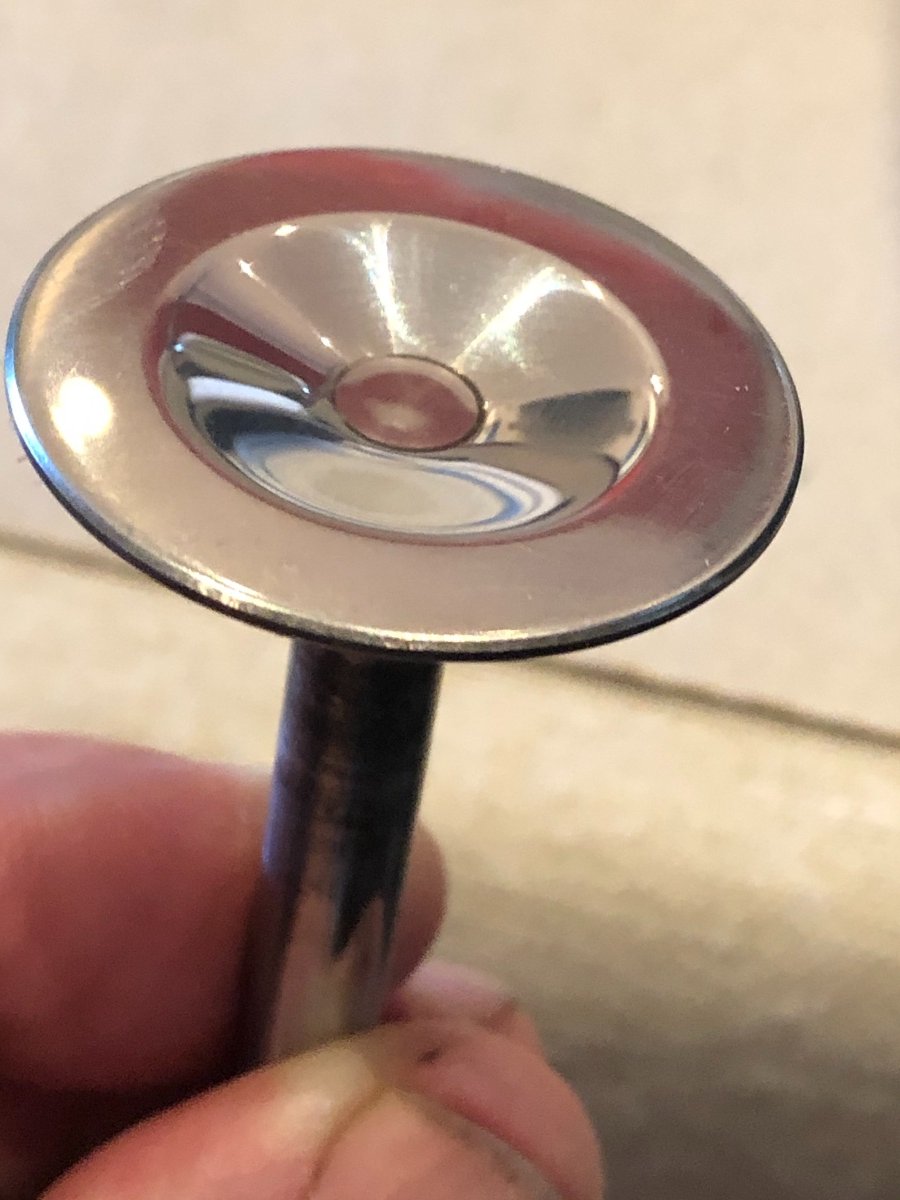

Area-51 Posted October 31 Author Share Posted October 31 After realising yesterday the valve head crazing was deposition, out of interest today I took to some old skills and decided to see if the deposition could be removed. Link to comment Share on other sites More sharing options...
facthunter Posted October 31 Share Posted October 31 Most engines have larger dia exhaust stems on the exhaust valves to help move the Heat. Anyone can see the weakening of the present valve stem and I'm not convinced the Sodium would make that much difference. The valve seat is the Path most heat will pass through. What price is on them? Nev Link to comment Share on other sites More sharing options...
facthunter Posted October 31 Share Posted October 31 It did look metallic and I doubt it's due to lead... What's your thoughts after removing it? It could be from an aluminium shaving/burr from some where upstream in the inlet or turbo. Nev Link to comment Share on other sites More sharing options...
Area-51 Posted October 31 Author Share Posted October 31 The turbo unit is in as new condition and free of compressor binding... If I knew these engines as well as I know others I would now use them without concern. But I don't have enough time on these things to know their practical limitations. Will still put set of standard valves in to tick the box; about $550 a valve. The engine is being built for reliability and distance work. Old ones can get polished and put into a lesser 80hp scavenger rebuild test pig unit. Link to comment Share on other sites More sharing options...
facthunter Posted October 31 Share Posted October 31 If it's any help to you I've seen aluminium produce just what you appear to have. Bits hang about in the combustion chamber and don't easily exit the exhaust port as you might intuitively expect it to. I won't post any more on this unless you ask. Nev Link to comment Share on other sites More sharing options...
