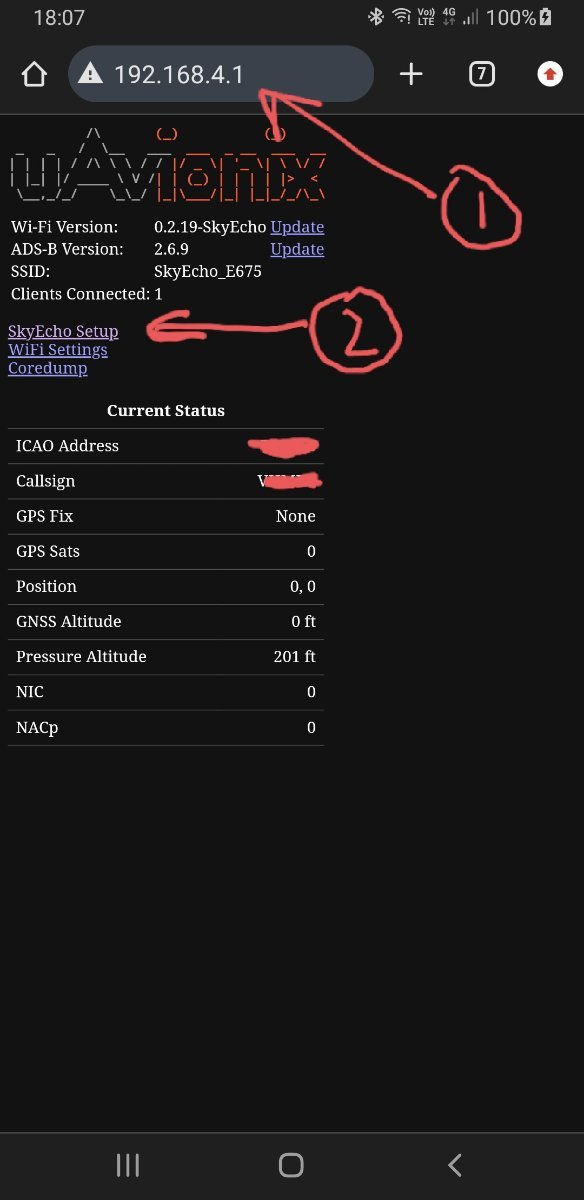

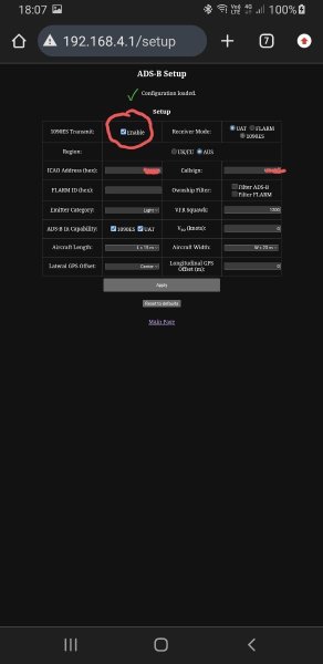

Bosi72 Posted November 6, 2024 Posted November 6, 2024 From your phone/tablet/ipad connect to Skyecho wifi. Once connected, open browser and 1. type ip address 192.168.4.1 (this might be different). 2. Tap SkyEcho Setup On Setup screen below, confirm 1090ES Transmit is ticked as Enabled. Also confirm other parameters including your rego and hex code. If not, tick Enable, Apply, Main page, then Setup again to confirm the change is applied. If ADS-B led is not blinking, then I suggest to contact uavionix support. Let us know how you go.

Bosi72 Posted November 6, 2024 Posted November 6, 2024 15 minutes ago, Philster2001 said: Also have contacted CASA for a ICAO code… Assuming this is VH aircraft, the ICAO HEX code should be written on your aircraft's "Certificate of registration", under Notes at the bottom of the document. You don't need to fly to test it, should be able to do that on the ground.
