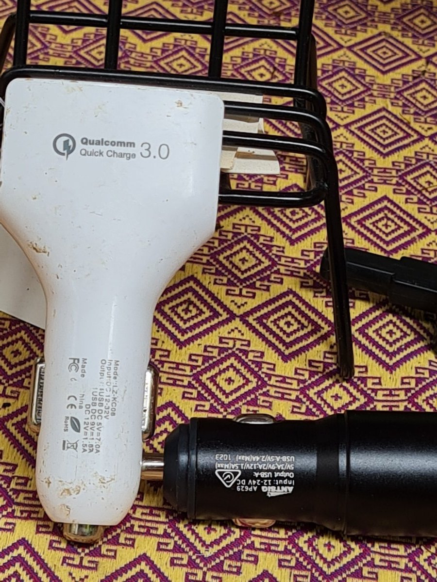

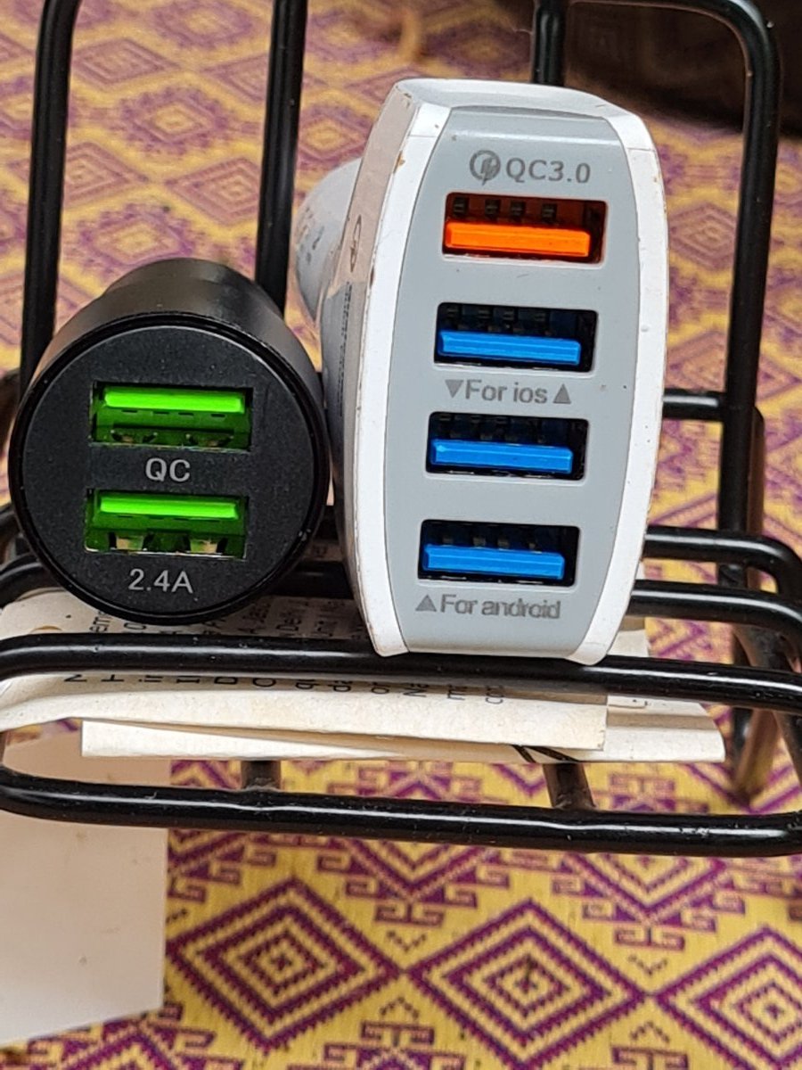

coljones Posted November 12, 2024 Posted November 12, 2024 There are 2 (or more) charger standards 1. QC - Qualcomm 2. PD - Apple? The SE2 conforms to the QC standard. Apples conform to the PD standard. If you want to "properly" power an SE2 (or Samsung kit) choose a QC compliant power pack. I have attached pics of 2 car chargers that have QC compliant ports and std USB -A ports. The white one also supports IOS but I'm not sure about the standard 2

kgwilson Posted November 12, 2024 Posted November 12, 2024 USB PD stands for Universal serial bus power delivery. It has nothing to do with Apple or iphones. It is a universal standard that delivers 5 amps at varying voltage inputs with a maximum out put of up to 240 watts. Many low input devices will not communicate with PD chargers including the SE2. QC3 is indeed a Qualcomm proprietry product with less output at about 36 watts. QC 4 & QC 5 are much faster & can charge at astonishing speeds like charging a mobile or tablet from 0 to 50% in 5 minutes. 3

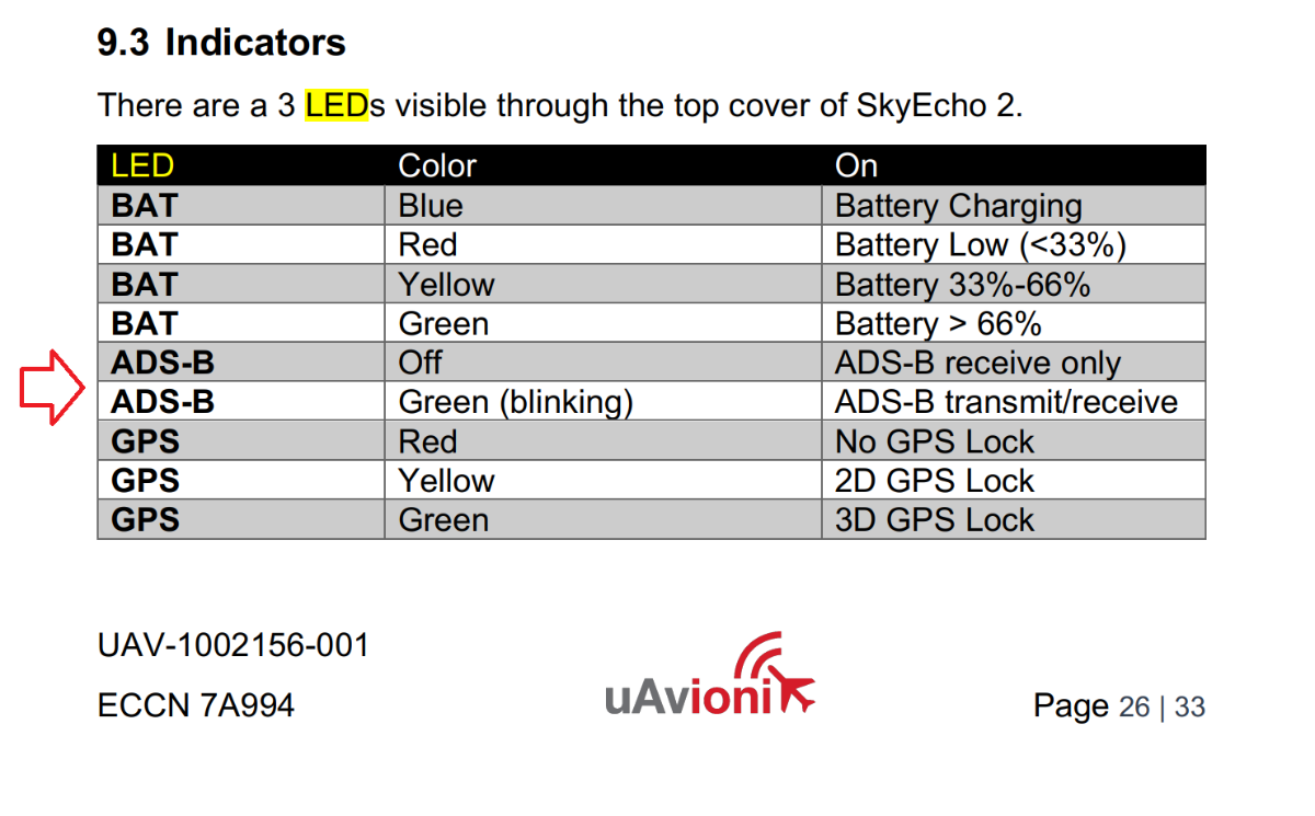

Philster2001 Posted November 13, 2024 Author Posted November 13, 2024 Thanks, I think I’m still confused as ever about the FlightRadar24. Maybe a better question to ask is - is the flashing ADSB light the correct operation of that light or should the light be solid green like the GPS light? Of course the user manual has nothing about the operation of the lights! The reason that it originally came to my attention was that a commercial flight inbound for Albany ( flying doctor I think) said they couldn’t see me in the circuit, and that made me wonder whether it was because my Skyecho 2 wasn’t configured correctly….
coljones Posted November 13, 2024 Posted November 13, 2024 35 minutes ago, Philster2001 said: Thanks, I think I’m still confused as ever about the FlightRadar24. Maybe a better question to ask is - is the flashing ADSB light the correct operation of that light or should the light be solid green like the GPS light? Of course the user manual has nothing about the operation of the lights! The reason that it originally came to my attention was that a commercial flight inbound for Albany ( flying doctor I think) said they couldn’t see me in the circuit, and that made me wonder whether it was because my Skyecho 2 wasn’t configured correctly…. Did he have ADSB in or was he relying on a 3rd party product like flightradar24 or your operation of an EFB being broadcast to other users of that particular EFB system?
Bosi72 Posted November 13, 2024 Posted November 13, 2024 6 hours ago, Philster2001 said: Of course the user manual has nothing about the operation of the lights! not true. https://uavionix.com/downloads/skyecho/SkyEcho-User-and-Installation-Guide.pdf page 26. paragraph 9.3 Indicators 1
