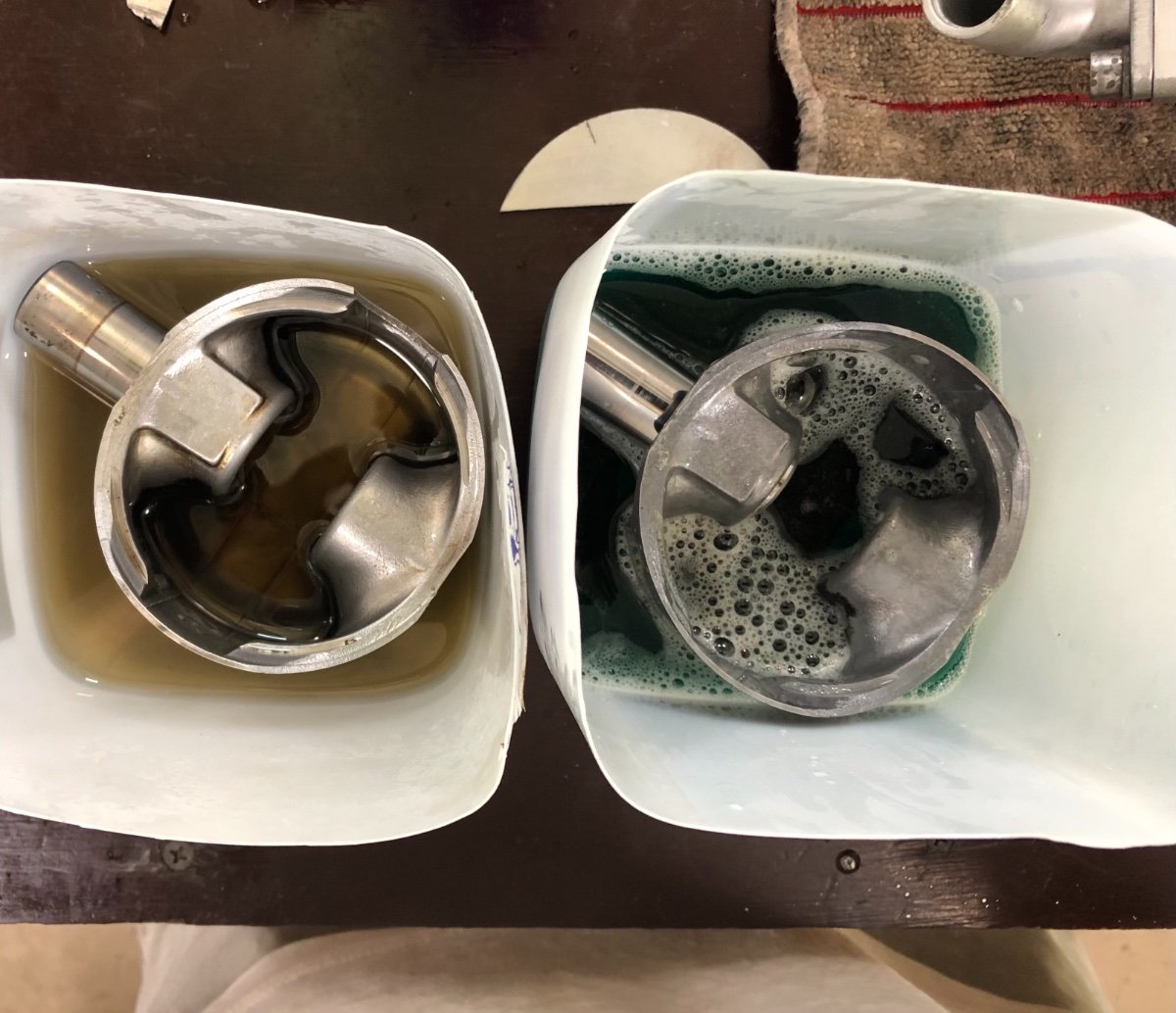

Pistons from the scrap 912 80hp were used to test some science. One was thrown in a bucket of Selleys sugar soap (oven cleaner), the other in a bucket of nanoic acid (herbicide). After 15 minutes the sugar soap had softened the varnish which could be wiped off with a rag. After 30 minutes more varnish came off with a tooth brush; and after an hour most all varnish was vanquished, and the metal was just beginning to dull a bit. After two hours the piston was stripped fairly clean and the metal had not dulled that much in total. The second piston is still sitting in the nanoic acid at the end of the day without much change at all.

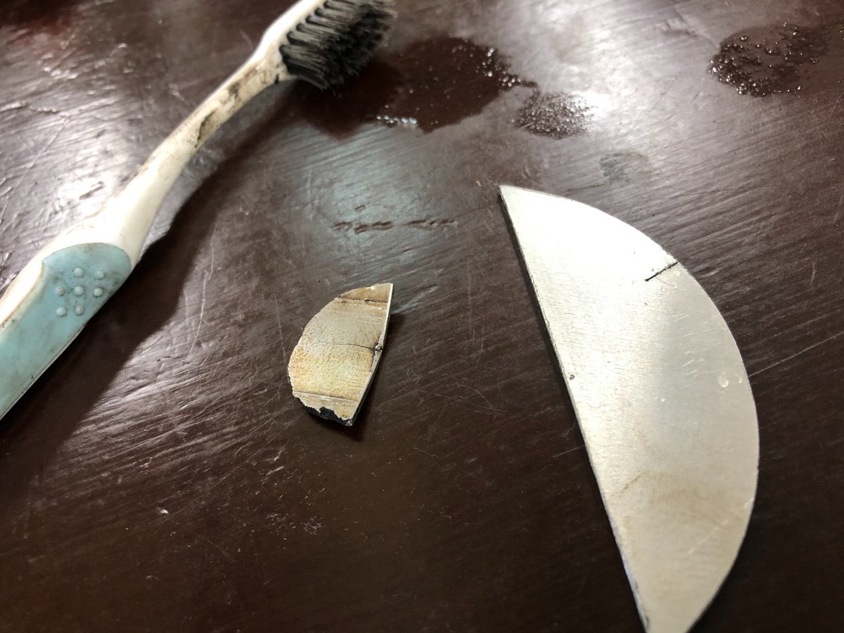

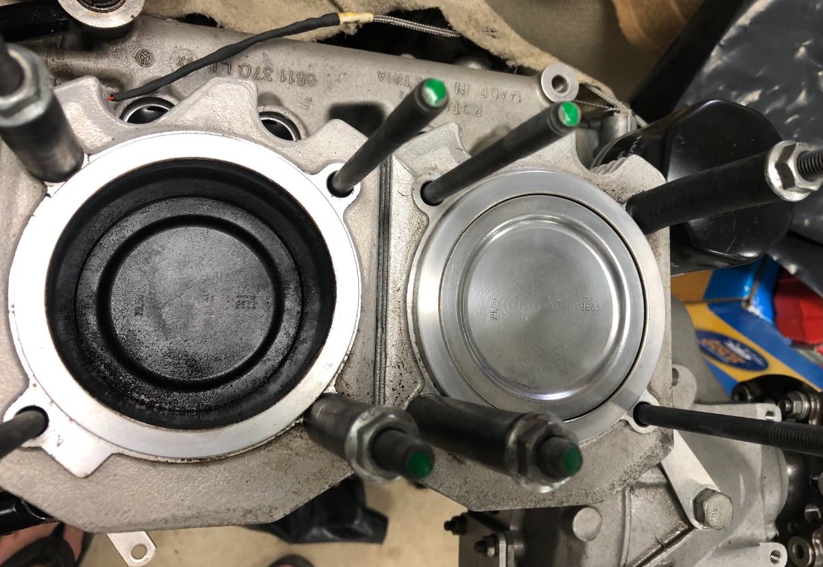

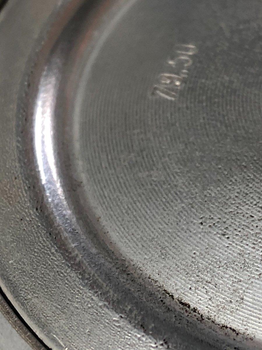

Then it was time to clean piston crowns. First a plastic scraper was tried and was all but useless at scraping off carbon. Then a piece of ebony was used, and was all but useless. Then a brass brush was tried which left scratch marks. Then a piece of 1.75mm aluminium sheet was tried. It worked great and left no scratch marks! Then a piece of broken piston skirt was tried and it worked even better, and left no scratch marks because it was the same hardness and material as the piston crown... After nearly 50years I just discovered this today; amazing...

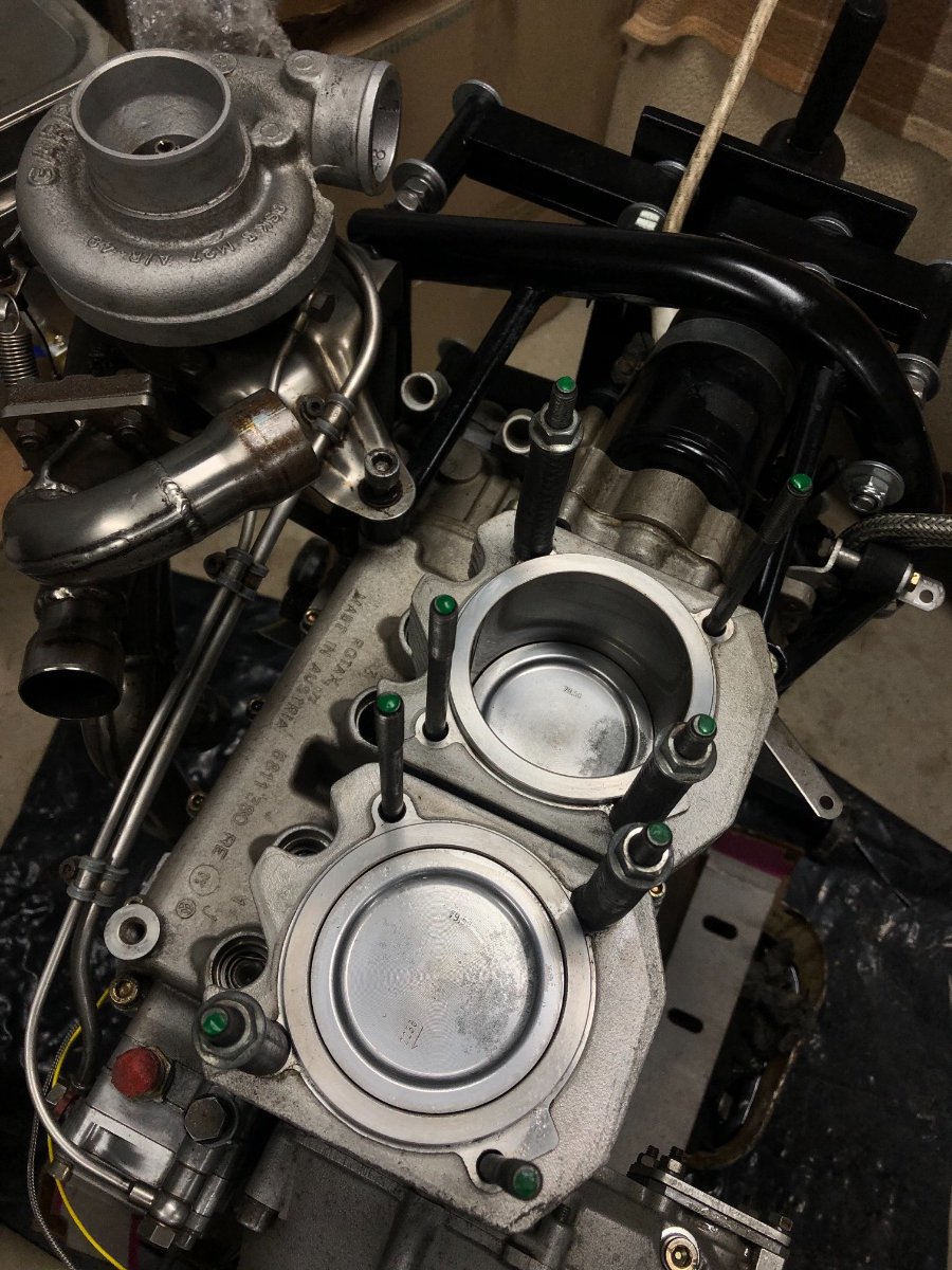

With all the wonder of discovery the piston crowns on the 914 all got cleaned as well as they could in the afternoon by first scraping the carbon off with the bit of skirt followed by a 15 minute soak of sugar soap and a flush out with carbi clean and Rostoff, followed by roll over until no more gunk flowed out of the ring lands, then a finishing off of engine oil.
E6CB4B64-0099-4C31-90B4-A558C5E3FC53.thumb.jpeg.f5f64716e95b8958dc88c8320401ca48.jpeg73C38873-010C-4897-A50F-8EA2D589DB88.thumb.jpeg.c2029816cb1ac8ad5ee85dce5860dff4.jpeg

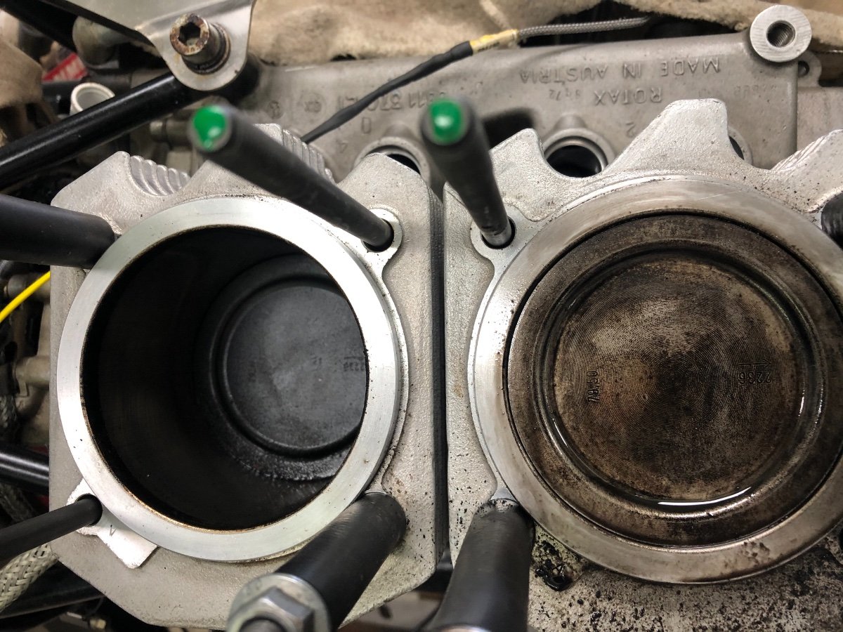

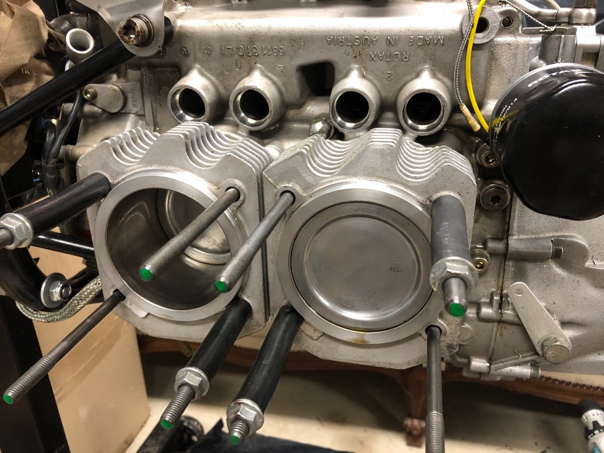

The carbon on the top of the bores came off easy after a scrape with the piece of skirt and some light wiping with grey scotch brite soaked in sugar soap.
Ready for reassembly...

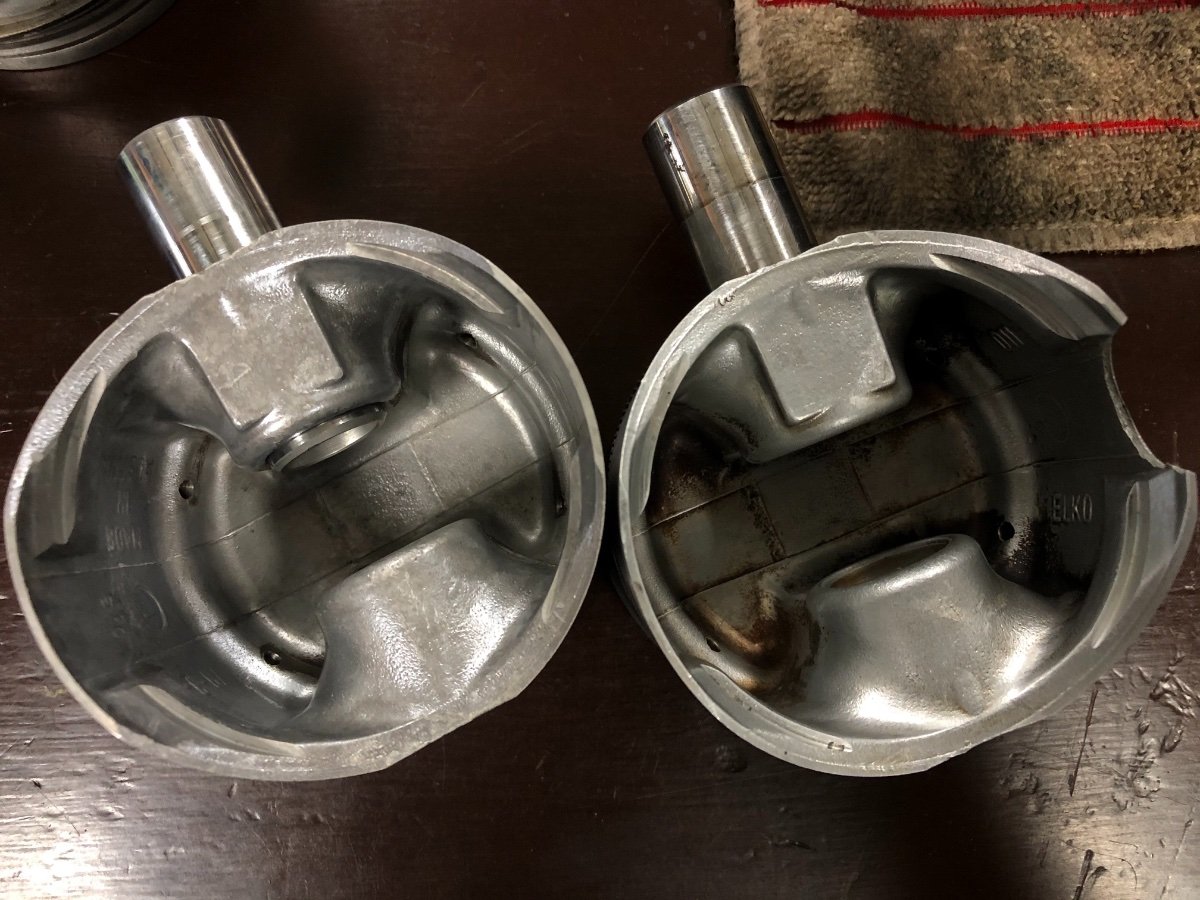

Pulled the test piston out of the acid bucket this morning. It did not clean off the carbon as well as the sugar soap, and did not dull the metal.

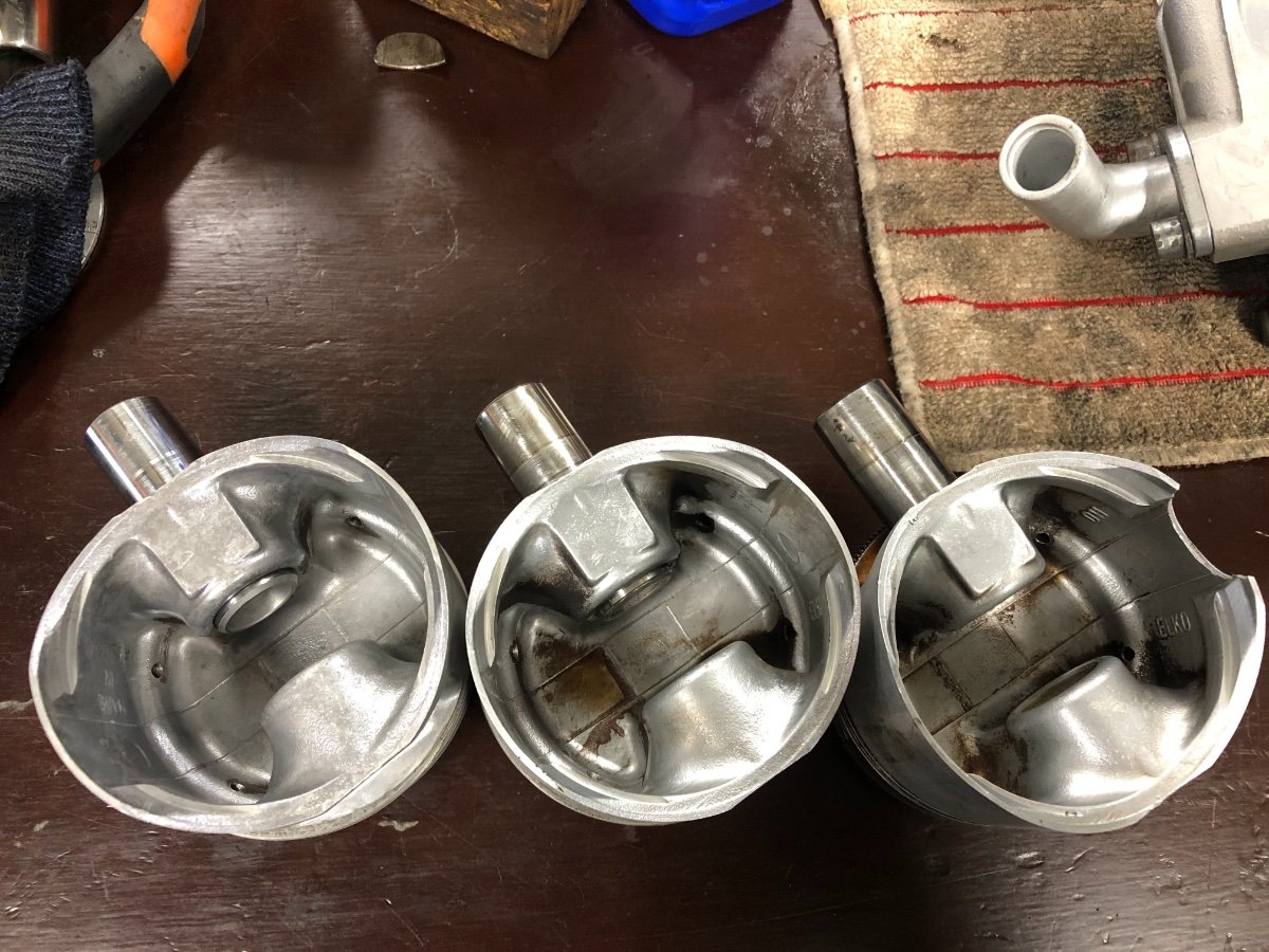

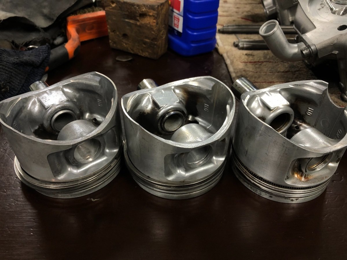

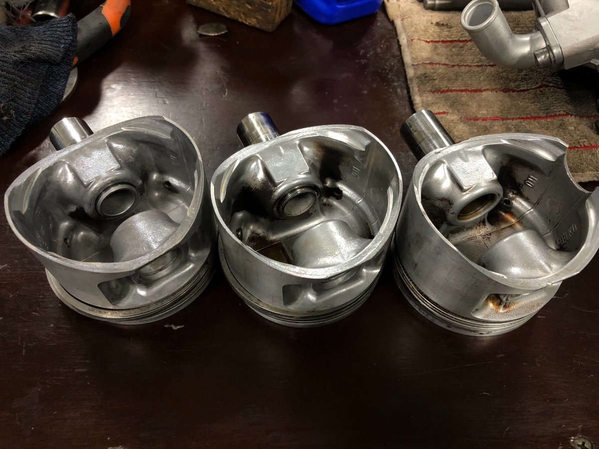

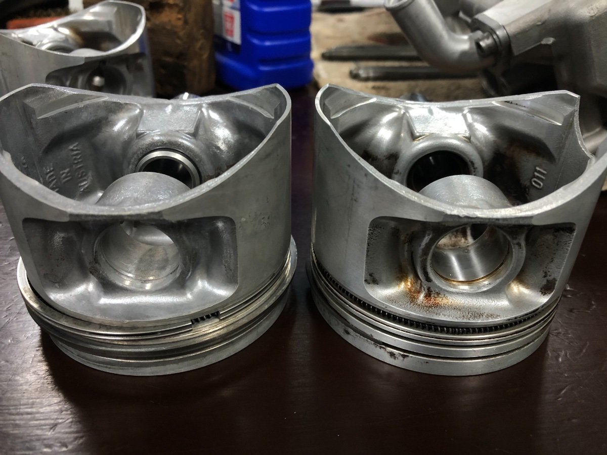

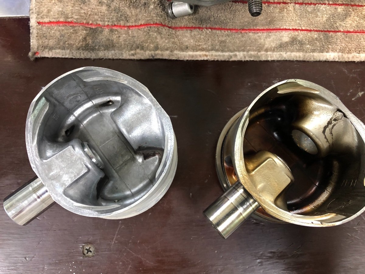

Below are the test pieces. Right to left, acid 24hr, sugar soap 1hr, sugar soap 2hr. And a couple of pics showing colouration between 24hr acid and 2hr sugar soap.616CDCF2-AF29-4352-BE01-0E6AF4C23630.thumb.jpeg.632b561564ad27732f2c54c1caa306cf.jpegD88D2939-B4DF-44B7-B39D-846FBBBA618C.thumb.jpeg.9eda3bdd7b10facd7c3ce81039899123.jpeg4E2B6DDA-0FD2-452D-AE14-851790D4EB85.thumb.jpeg.e9a211f343d3aeacf7371dbd56b2eb97.jpeg4ADE584B-75C9-41AD-AF74-60F3355EE356.thumb.jpeg.23fdecb7dc423c2983a4c2ec0882da7d.jpeg31313C2A-A0B4-4E7E-BF6D-906A6B192760.thumb.jpeg.653212dc9be32c5625e3861e8903c6eb.jpeg
