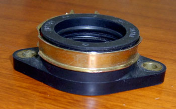

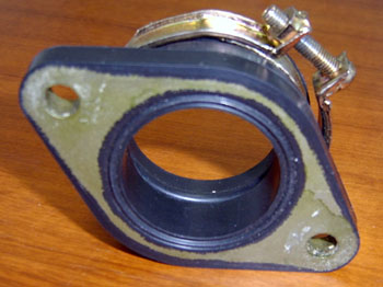

Another tidbit of info that some might not give a second thought to.
The following pics are of a Japanese made carburettor mount which was new when put on, though not long after failed. Hours to failure unknown. Aircraft type unknown. From the outside all seems normal though underneath lurks the problem.
The number stamped on the top is 267787
Chris
Could this have been from incorrect fitment of carb ( not seated fully) or caused by the clamp overtightening? rather than material failure.
juz curious
Hi Ozzie,
Possibly incorrect mounting. As you can see in pics 1 and 3, there is a ridge running around on the inside of the mount. The split runs along the bottom of this ridge.
The clamp itself could not cause this through rubbing as the edges of the clamp are raised for a start and the split runs around in the middle of the clamp area.
Chris
