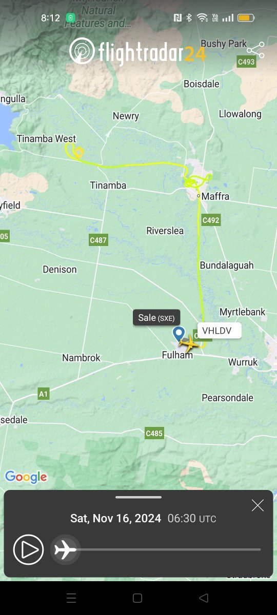

on flight radar there was a 4 seat morgan cougar circling at 400 ft @60 knts. disappeared after circling twice.

It did a lot of tight circles around. Maffra before heading over to upper Maffra . Might have been looking or knew people at the vintage truck show which was on at the Maffra oval.

Seems likely given the flight track and the flat nature of the terrain. Can't see a strip there so maybe a moose turn stall spin.
We learn the aircraft had changed hands only very recently. Wind out of the north at 20 knots may have been producing some turbulence. Sad situation.
it can get pretty bumpy close to the hills there and a northerly would make it rougher. temp was about 28 to 30 .
