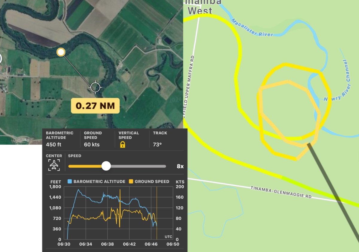

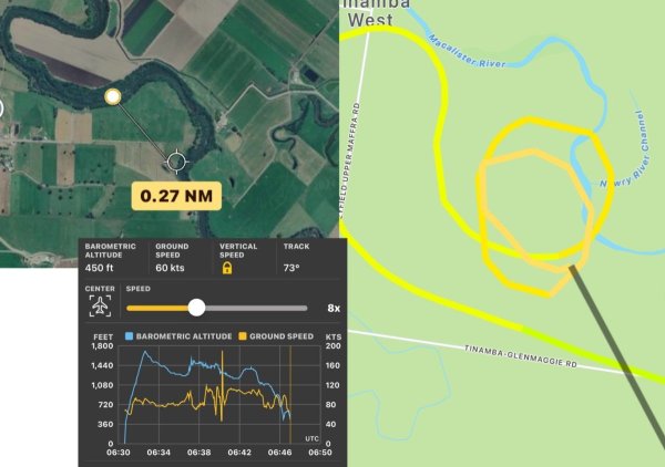

spacesailor Posted November 17, 2024 Posted November 17, 2024 Aircraft travelling at 60kn downwind. ' 80 kn ground speed ) Turning at normal rate into headwind , the ground speedwell drop to 40 kn . Any windshear will drop your wing fast . ( according to my instructor ( always add airspeed when turning slow,). spacesailor 2 1

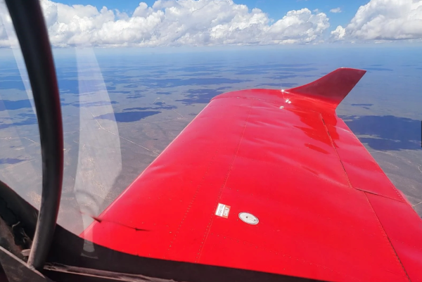

pylon500 Posted November 17, 2024 Posted November 17, 2024 There is a relevant detail in the spec sheets, 90lts in a fibreglass header tank, in front of the instrument panel... Having a few hours in Garry's blue prototype Cougar, there is a noticeable CofG shift as fuel is burnt off, the subject plane also had wing tanks, behind the wing spar. Now throw an extra body in the back seat, and life can get interesting if you're not on top of the fuel system.😳 On a side note, interesting to see a '100LL Avgas only' sticker on the fuel cap, but I guess if it had a home made turbo system on a 912ULS, it may be the case...🤔 1 3

onetrack Posted November 17, 2024 Posted November 17, 2024 Quote I may have this very wrong - Once airborne, unless subject to turbulence/wind shear/ gust, the aircraft does not "know" or care from which direction the wind is coming from. The aircraft will perform just the same with a 20 knot tailwind, as a 20 knot headwind. The ground speed will differ but the air speed remains the same Expand Skippy, I've got no problem agreeing with your correct understanding of how an aircraft travels in a pocket of air, and does not "know" where the wind direction is from. But time and again, we see pilots crash at low level, and especially when banking or changing course, and they're looking for and acquiring a ground reference, which can distort their perception of air speed. As Facthunter has pointed out, close to the terrain is risky operation, and things can go bad very quickly, if you're not expecting bad things to happen. I'd have to opine, you can't put an old head on young shoulders, and youthful inexperience must have been a feature of this tragedy. I'm talking inexperience in total logbook hours, inexperience with low level flight and possibly gusty conditions, and inexperience with a relatively new (to him) aircraft. 1 3
BrendAn Posted November 17, 2024 Posted November 17, 2024 he was flying 100 ft below minimum legal height so when things went bad they were on the ground in an instant. i went past there tonight on my way to work, there would have been close to a dozen people walking around the site. very thorough. the thing i keep thinking about is the parents who lost 2 sons and a nephew at once for no good reason. 1 1 1 1

Red Posted November 17, 2024 Posted November 17, 2024 On 17/11/2024 at 4:54 AM, skippydiesel said: I may have this very wrong - Once airborne, unless subject to turbulence/wind shear/ gust, the aircraft does not "know" or care from which direction the wind is coming from. The aircraft will perform just the same with a 20 knot tailwind, as a 20 knot headwind. The ground speed will differ but the air speed remains the same. Expand Whilst absolutely true in steady windspeeds there is a caveat you have to remember an aircraft has inertia, the heavier it is and the faster it is travelling the greater the inertia, this evidenced in Gusty conditions when you will notice your ASI Fluctuating as your aircraft doesnt immediately adjust itself to its trimmed speed. This is also applicable to an aircraft turning sharply in high windspeeds, there will be a lag in the aircraft re-assuming its trimmed speed, the lag being in proportion to the aircrafts inertia In Reality with our low inertia aircraft at relatively low speeds this is not a major consideration, but the effect does exist. 2 1

Mike Gearon Posted November 17, 2024 Posted November 17, 2024 (edited) Heart goes out to that family that lost the boys. I’m building an aircraft at the moment and talk with my daughters about one of the three grandchildren maybe taking over the S21 one day. Maybe the motor glider is a better option? I just purchased a Diamond aircraft Super Dimona. Was reading up on the Diamond DA40 accident rate. It’s super low. Read below. No stall related accidents. The flight data when combined with a rough measurement of the turn along with altitude and speed don’t look good. The DA40 has accumulated a very low accident record, particularly with regard to stall and spin accidents. Its overall and fatal accident rates are one-eighth that of the general aviation fleet and include no stall-related accidents. The level of safe operation is attributed to its high aspect ratio wing, low wing loading and benign flight characteristics. The aircraft can be trimmed full nose up, engine set to idle and it will descend at 600–1,200 feet per minute (180–370 m/min) at 48 kn (55 mph; 89 km/h) hands-off, a lower rate of descent than the competitor Cirrus SR22 can achieve with its airframe ballistic parachute deployed.[13] Edited November 17, 2024 by Mike Gearon 3
facthunter Posted November 17, 2024 Posted November 17, 2024 Turbulence and/or control inputs create extra drag as well as banking. Ground effect can help if you are not above 1/2 wingspan from a fairly level surface. (Not trees). This is general comment. We don't really know what happened here except 3 young people's lives were lost. Nev 2
