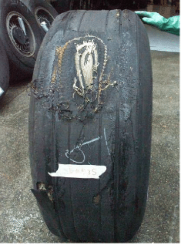

skippydiesel Posted November 19 Posted November 19 "..........aquaplaning can get rid of a tread in 1 landing" Please expand?😈
Deano747 Posted November 19 Posted November 19 (edited) Happens to all tyres - cars as well. If the wheel locks (ABS inoperative) (not a no-go item) on the top of a film of water, then the friction heats the water to boiling and melts the rubber. Tyre not spinning so a localised melt. Why pilots never aim for a 'greaser' on a wet runway. You want to get the tyres through the film of water onto the bitumen. Heavier the rain the more positive the touchdown. Edited November 19 by Deano747 1 2 4
