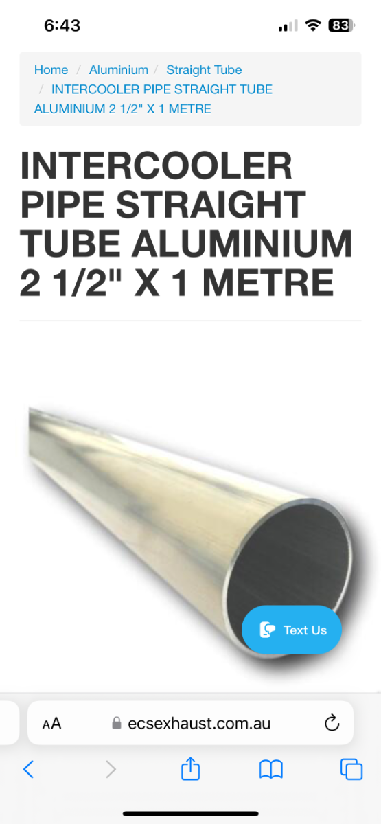

So this sounds like an exhaust augmented cooling system? One option would be to roll the desired material  and secure with hose clamps or tig weld.
11 hours ago, rodgerc said:
Thanks Roger - Most of this pipe has the wrong ID but as I said I am talking to a custom intercooler manufacturer who may be able to assist me.
